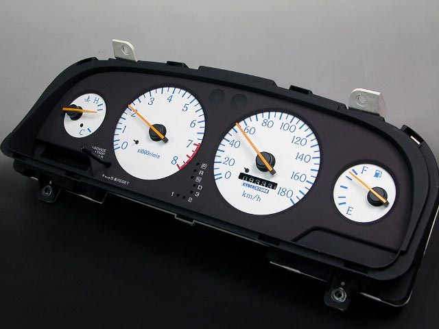

after I posted that I saw these - which even have the same layout as the Q, plus the mph etc. look to be in the same positions - may be off a hair though.
