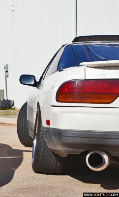

how much would you guess i have now?
poshatch
Posts: 853
Joined: Thu Oct 15, 2009 7:44 am
Car: p.o.s. 1990 240sx hatch
id say from that picture you got close to -3
