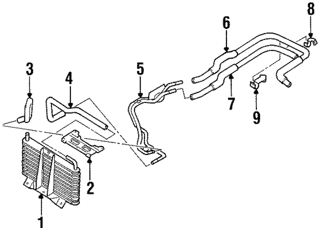

I'm TT but it looks like the lines are cut by the previous owner at the two hardpipes right next to the radiator?
If you view the diagram here https://dz310nzuyimx0.cloudfront.net/st ... 7b132d.png
the silicon lines are cut at "5"
Is there a line reroute that people do?...

Why someone cut the hard lines when the connections are only a few inches away is beyond me.WTF.

NolimitZ32
Posts: 7042
Location: Houston, TX
Basically. You remove the compressor and turbine housing from the old cartridge and mate them to the new cartridge, clock the housings correctly and reuse all the hardware to secure.
itsa300zx
Posts: 1287
Joined: Sun May 31, 2009 9:39 am
Car: 1990 300zx NA W/TT swap
2011 Nissan Rogue S
2008 Highlander SR5
Location: up North
CHRA change is quite basic, only issues I've ran into are seized bolts. Scribe and mark the orientation before disassembly and don't wash out the markings( Ask how I know, brake clean washes out 90% of inks/paint, LOL).
You should also check with your local turbo guy if they can source Sp 500 CHRA; looks like they are Garrett suppliers too. Never know, might be cheaper than Z1.
Absolomb
Posts: 65
Joined: Wed Jan 25, 2017 5:44 pm
I just wanted to update you both here and thank you again for consulting with me. I pulled the engine out yesterday and again referring to the oil cooler lines that were cut, Again if you are facing the engine there are two hard pipes sitting next to each other that pop out down to the left, that are visible with the radiator removed and there are soft lines that connect from there to, apparently, the oil filter tree? Well out my engine came without removing any other lines. Was the prior owner NOT running the oil cooler? Is that even a thing? Did the prior owner cut the lines are forget to install new ones? Would oil NOT have been spewing out of the hard pipes? Is that perhaps why my cylinder 5 and 6 are damaged? I dont even know what to think. We are getting hit here on the east coast by storms the nest few days so I wouldnt be out to inspect further. I wanted to get my heads off the block so I could take everything inside but I ran out of time so I had to tarp it on the stand outside and hope for the best. I wish I had a garage right now more than ever.
