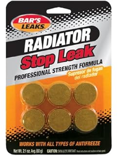

Add a tube of bars leak power (NOT THE SILVER CRAP) to the cooling system. Run it for an hour or two, give it some revs and turn on the heat to circulate it, then flush and fill with fresh coolant. That should keep it going for years.
The powder is basically ground ginger, harmless and at one time offered by GM as an OEM part.

Jesda wrote:Add a tube of bars leak power (NOT THE SILVER CRAP) to the cooling system. Run it for an hour or two, give it some revs and turn on the heat to circulate it, then flush and fill with fresh coolant. That should keep it going for years.
Awesome. I will give this a try. That's basically what I was looking for: a low-cost way to buy some time.
I take it you mean use the Power Steering stuff rather than the stuff that's supposedly specifically for the cooling system?
Comes in powder or tablet form. Both work fine.
Wal-Mart has it as do most Cadillac dealers.
Somehow it manages to plug small leaks (it's useless on large leaks or cracks) without clogging the system. How that's possible is beyond me. The magic of ground ginger root.

that's interesting that Caddy dealers stock that stuff. To me it seems a cheapie way to avoid doing a proper diagnosis and repair, but then again we're talking about GM. I'd only suggest using that stuff if you're getting rid of the car.

Bubba1 wrote:that's interesting that Caddy dealers stock that stuff. To me it seems a cheapie way to avoid doing a proper diagnosis and repair, but then again we're talking about GM. I'd only suggest using that stuff if you're getting rid of the car.
I would say, "Just go shopping" ---THAT DAY--- but I know that isn't always possible. I'd be looking like crazy though, even if it is another beater but in better mechanical condition. You do not want to tackle that HG and if it fails, you're stuck with very ugly yard art.
Used it in my Q45 to seal up a small, annoying leak in the plenum valley. Worked wonders.
Don't knock it until you've tried it.

I have used that sealer stuff before, (in an old Buick of all things), but only because I was in the process of selling the car.
