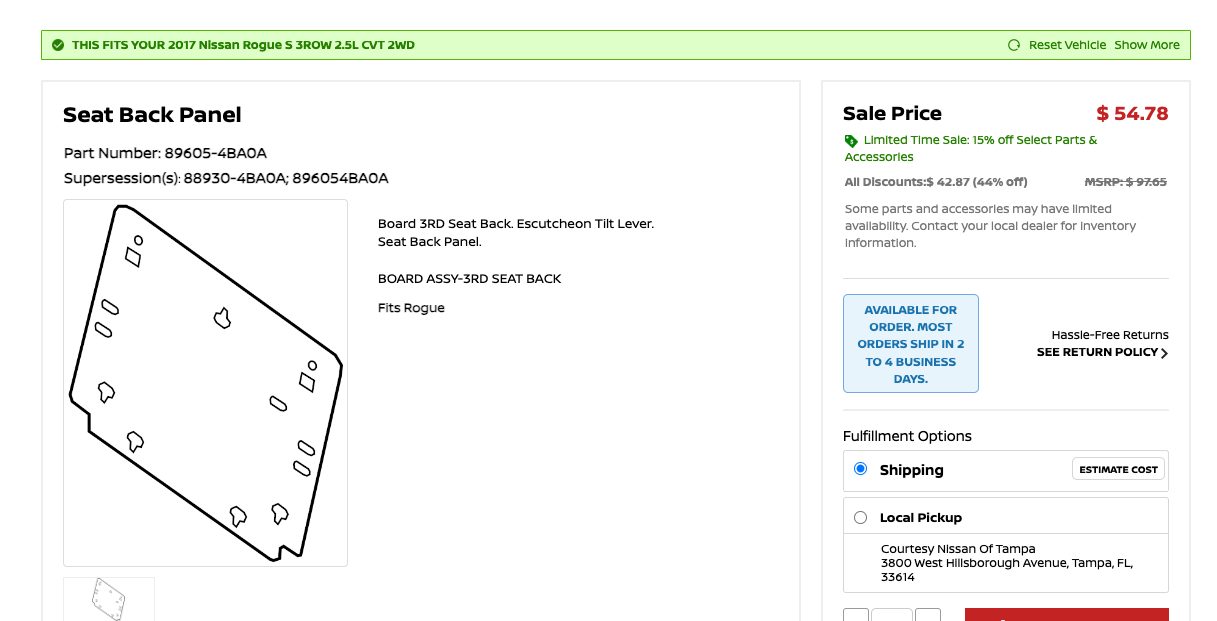

Is this the seatback board (Seat Back Panel) we are talking about? https://parts.courtesynissanoftampa.com ... 4BA0A.html
There are many holes in the image. Are those the places for clips that you were talking about? Imagerussian image hosting
I need to use some tools to unclip the clips or hooks to remove it? Was trying to search some youtube videos on this and couldn't find any.

Those are keyholes in the rear side of the backboard which don't go through to the outside, they sandwich the clips between two inner boards. You'll see what I mean when you remove the board. The keyholes are usually what get torn and need some repair when you remove one. Hopefully the third row clips are the ribbed type and not the crappy pawls they use on the second row. The ribbed ones usually come out without damage. The Parts Catalog shows a different part number for the third row, so it may or may not be a problem. You'll have to let us know, because it's not the sort of thing I want to pull apart experimentally on a customer car to find out.
