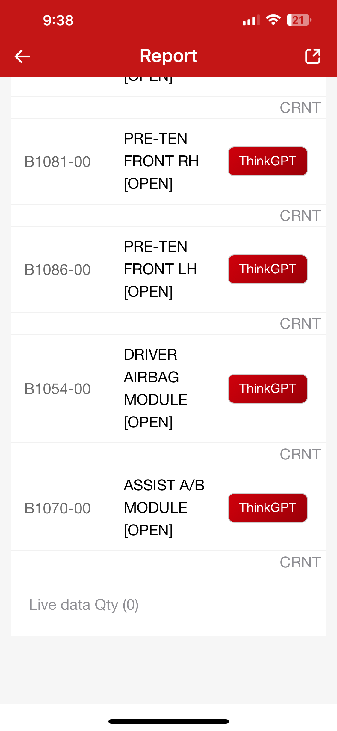

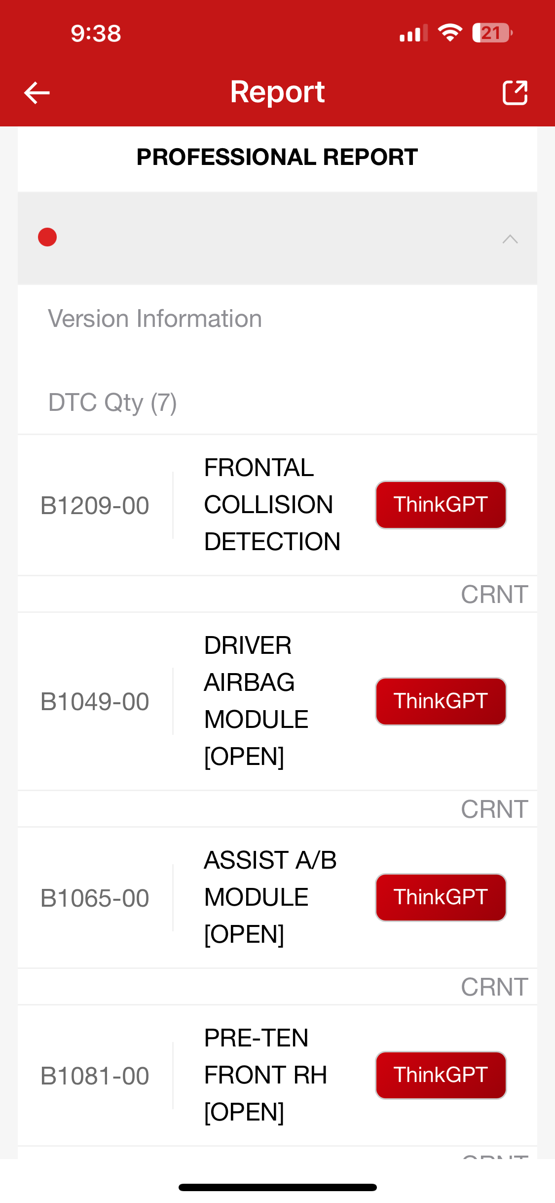

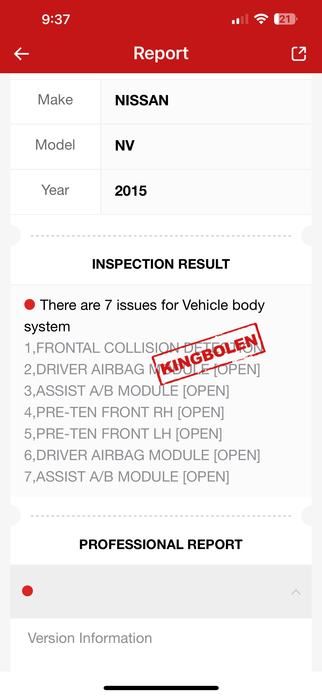

Hello everyone I am new here. I purchased third NV3500 from coparts that hit a deer. It starts and runs good, and airbags went off and seat belts also. I replaced them from a parts van I have. I ran the code reader before I started the replacement (see pics include). My question is, can I just start the van up without replacing any sensors or control modules? I have not installed the battery for fear that a bag might blow. I’ve included some pictures. Not sure how to upload the pics. I tried using the tools.

Okay, I just got a look at your pics and the B1209 code is the "crash code" which you won't be able to clear. The rest are all bag and belt codes, it looks like the zone and satellite sensors all survived the accident. So if you replace the Brain and make sure there are no driver bag codes after replacement (which would indicate a damaged clockspring), you should be good to go.

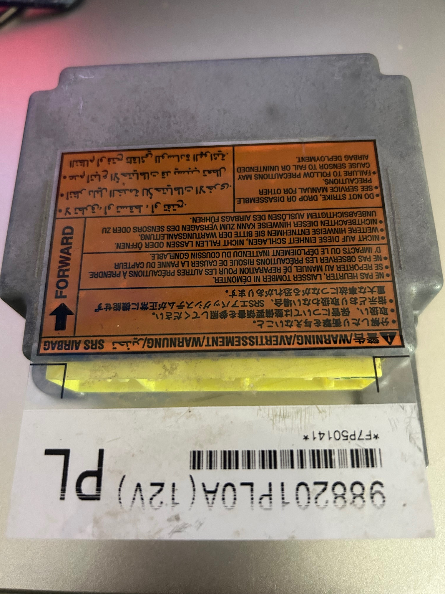

Thanks for the help really appreciate. There are two boxes under the center dash console. Can you tell which one is the brain?

Well, I'm back at the shop and can't see the pics, but the Brain will have an orange or yellow top label with a bank of 3 yellow connectors across one end.

I pulled the ACU going to send it in to my air bags .com to get reprogrammed. The spare one has different numbers on them. I was able to move the van after I pulled the air bag fuse, thanks. Is there any sign that the clock spring is bad? Like the horn not working?
