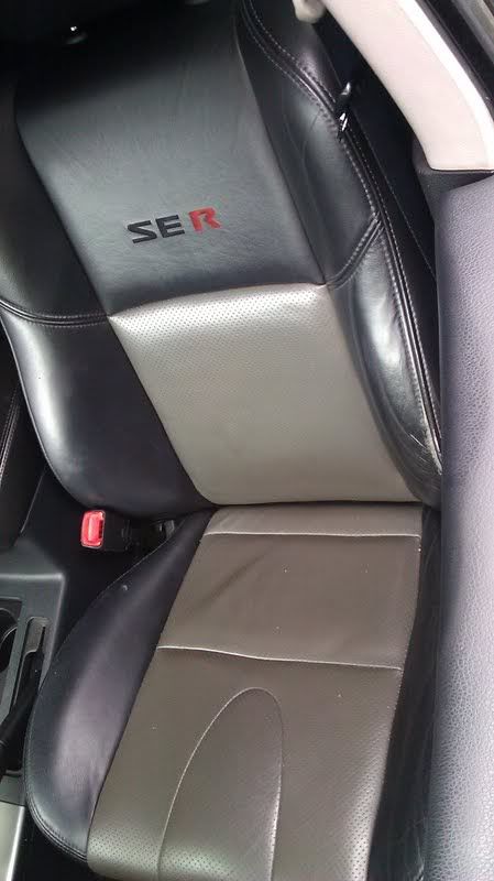

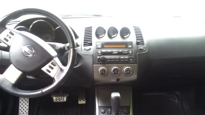

Here are the pictures
Thanks VQ and I've always liked that race red looks sick bud.! :mike
