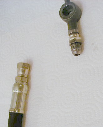

Found one - at least I think so! I picked up the hose this evening and will put it on tomorrow. Cost about $55. They cut the ends off of the old hose, welded a "standard" connector on there and then made a hose to go between them. Pretty much what AZQ45 said the place in AZ did.
I took some pictures that I'll post later...

Q451990 wrote:I took some pictures that I'll post later...
It's Later...
Those are some fine looking hose. (Did I just say that?)
