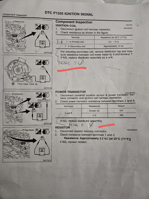

I appreciate your help !
It happened overnight. Car wouldn't start, no spark.
Followed the FSM and determined no resistance at the ignition coil, no resistance at the power transistor. (trying to say t r a n s i s t o r but for some reason it keeps auto correcting to transmission)
Distributor was replaced about 6 years/ 82k (51k miles) previously.
I have no fancy tools, is this something I need to bring to shop then?

Since you had a blown-short PTU, the biggest cause of that is crappy grounding. Bad grounds to the drive tran-sistor (yes, for some reason the editor does that with any word starting with "tran-s") cause it to overheat and melt, resulting in 0 ohms from the coil primary to the ground terminal. Check your distributor ground, sounds like maybe it's poor and temperature is affecting it.
