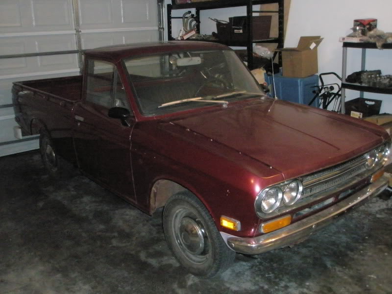

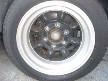

Picked up a lil something couple weeks ago, thought I'd share. Could use some cleaning. currently looking for some wheels. I know the ones I want, just hard to find.

Theres a bit of surface rust on the undercarriage, but it looks like whenever the truck was repainted they must have cleaned up and redone the undercoat on the cab, few small spots flaking off. Crawled all over trying to find some cancerous rust and couldn't. Hard to find something like this in the midwest as well.

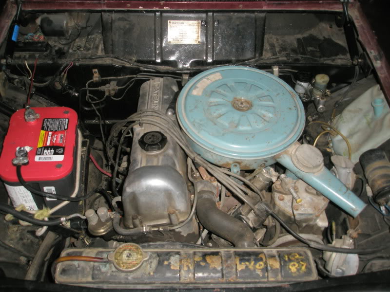

Switch to a balljoint disc brake set up in the front. Truck came with a spare l20b, need to decide between that and a ka motorset. ka would have more versatility as far as ac condenser for the under dash ac unit and possibly power steering. The l16 in there now idles real high, I noticed the carb was from an l20b so I'm not sure if it was rejetted or anything before it was dropped on the l16. I'll prob pull it off and check it. But definitely brakes first. Never had a four drum brake system before, and have had a couple oh s*** moments, especially after driving the 240 with z32 brakes.

Keeping an eye out for a motorset, I'm sure a wrecked 240 will come up sooner or later. In the end I think it would be cheaper than rebuilding the l20(I'd have to find a five speed as well), and less hassle sourcing parts for my end goals.

Have a little update, got parts together for a 5 lug swap. Using d21 spindle and brakes with a late 80's toyota hub up front, and picked up a 76 toyota 4.11 rear end for the back. measured out at 54" wms to wms so around 2" wider in the back then stock. Shouldn't be to bad will just need to play with wheel offset some. In the end I'll have 5x114 lugs so wheels choices will be infinite.
