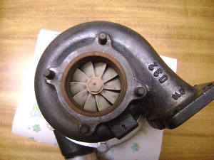

Bad news... Wouldn't you know it just as soon as Im starting to feel comfortable and trusting of this new setup and post it all up on here, the turbo is not doin so hot. Yea I took a chance and bought it used and i thought it would be ok since it had almost no shaft play, but it started smokin worse and now its toast after logging about 1000 miles on it at 8psi. I was hopin no fins touched so i could rebuild it myself and not need it balanced cuz I didnt want to have to pay to ship this weight out somewhwere and although there are a few reputable diesel shops nearby, I doubt anyplace around north central indiana provides this turbo balancing service; but I got it pulled out and there was definite contact. It was a blast while it lasted though. 8psi from this had noticeably more kick to it than the 10 from my t28 and spools almost as quickly too.
Camera's not the best but you can see where the scrapes are
And on the turbine side there are visible "cleaner" spots
And since it will be a couple weeks til I have the funds to put into this and the spare motor I just got, Im just havin my buddy cut a t3 and a 5bolt flange flange since he has access to a plasma cutter and ill tie it all up with some flex pipe and turn down the injectors for now.
But since I know im going to need this rebalanced and now I have a straight t3 and also a t4 layin around, Im considering maybe a diy hybrid.

Im pretty sure it had enough oil. It was getting enough to smoke out my exhaust while in boost. And Im using the JGS oil line kit with the same .063 restrictor that i used on my t25 for 2 years of daily driving with no issues. I just went with what the jgs website said which stated if your oil is any more than 50psi (mine read a little over 60 if I remember right) under load to use it. Maybe this turbo needed more? Or maybe it was just already on its way out when I bought it.
My pressure sending unit is on my oil filter sandwich block right next to the feed for the turbo, so shouldnt that give an accurate reading for what psi the turbo is seeing?? Cuz I really dont want to ruin it again after I rebuild it.
Any thoughts on using this t04b cold side with my t3 hot side???
I tore them apart and everything bolts up fine.
So I thought about rockin it like this and just grabbing one of the nicer rebuild kits with the 360* thrust bearing and sending it out to get balanced. I found this place, gpopshop, that does it for $65. Seems kinda steep and I still need to call a couple diesel shops around here to see if they can do it, but shipping wont be as bad as I thought since they say they just need the wheels, shaft, and thrust parts. Worth a shot? Or waste of time?

Slight contact is no good, imagine what kind of damage is going ensue when it's spinning at 75,000 rpm's. I would recommend purchasing a new turbo or repairing the Turbonetics turbo. Please do not try to do a home rebuild, send it off to a professional. Most people think you can simply swap in a parts kit, get it balanced and you're good to go. There are tolerances and clearances that also need to be check. Although I hate turbochargers.com's owner, his employee Mark (turbo rebuilder) knows his s***. Give them a call, they are direct with Turbonetics and might be able to repair your turbo on the cheap.

JDizzle wrote:Slight contact is no good, imagine what kind of damage is going ensue when it's spinning at 75,000 rpm's. I would recommend purchasing a new turbo or repairing the Turbonetics turbo. Please do not try to do a home rebuild, send it off to a professional. Most people think you can simply swap in a parts kit, get it balanced and you're good to go. There are tolerances and clearances that also need to be check. Although I hate turbochargers.com's owner, his employee Mark (turbo rebuilder) knows his s***. Give them a call, they are direct with Turbonetics and might be able to repair your turbo on the cheap.
Um, as far as parts that can be assembled wrong where tolerances are concerned...there are really none. I have rebuilt several and not even had them balanced. Balancing is the huge player because it's the vibration that kills the bushings or ball bearings. I've simply installed the parts according to index marks made prior to removal and have had lots of success.
I wouldn't use a compressor wheel that has made contact with anything, but I'd swap out the bushings without thinking twice. If it's getting balanced then I see no problem at all with a DIY rebuild. It's no more intense of a job then say rebuilding the motor. Yeah it's easier to send it to a shop but people do it themselves all the time. When done correctly, there will be no issue. For the price of a rebuild you can damn near buy a new turbo.

There are tolerances and clearances that need to be checked. For example, in an engine that has spun a rod bearing. Would you not have the crank machined and use oversize bearings?
When a turbo fails like this, it's usually only because of a couple of reason. Lack of lubrication or contaminated oil are two of the most common. Either one will damage the turbine shaft. Lack of lubrication (bluing on shaft) generally leads to you warping the shaft and it's no longer 100% straight but you can machine them to be straight again. Oil contamination will scare or scratch the shaft but that can also be machined. Both cases you will need to go with over size bearings.
The piston rings (seals) have a gap that needs to be checked just like the piston rings in an engine. If the gap is too big then you will have oil leaking. Each turbo has a different tolerance that you can check with a feeler gauge.
If you've rebuilt turbos without checking these and it worked, consider yourself lucky.
Balancing is also key when you replace key components like the turbine shaft or compressor wheel. If you're just swapping in new bearing you can get away with marking the parts so they go back together in the exact same orientation they were in.

JDizzle wrote:There are tolerances and clearances that need to be checked. For example, in an engine that has spun a rod bearing. Would you not have the crank machined and use oversize bearings?
You're misunderstanding what I'm trying to say. You see things in black and white, where I see everything as a various shade of gray. Not that I need to qualify my statements, but I do have 13 years of experience in rotating objects. I was a helicopter mechanic in the USAF and have used all sorts of vibration analysis software and hardware. I've had balancing specific training and can tune everything from gearboxes to rotor heads.
What I meant when I said things can be rebuilt is that once they're inspected you can rebuild the turbo and then have it balanced. After said balancing the turbo will work great for quit a bit less money. If I take apart a turbo and things are worn I replace them. I've had probably 25 turbo's taken apart in my time tooling around and none has any shaft warpage. Some had been scored and some had been over temped but none have been warped. I'm betting anything that has been warped has exploded and doesn't even have the exhaust wheel attached anymore.
Also, if a shaft is warped, it's tossed not machined.
I hold DIY people to a high standard. Not every Joe Blow can rebuild a motor correctly or take apart a turbo and reassemble it. It takes skill and knowledge. But not alot and most decent mechanics could easily do it with the proper tools and a couple junkyard turbo's to practice on. I cut my teeth on turbo's over in Japan, so burnt up turbo's were lying around. Taking one apart without having to worry about putting it back together makes it easy to learn ;) Point being, if you don't know what you're doing then don't do it. Everything you mentioned that requires checking is right online. When I say something can be done, I don't mean to say any waterhead can rebuild something that spins at 300,000 rpm.
A digital caliper is cheap at harbor freight btw, makes it real easy to spec things out. If it's damaged buy a new one, if it's not then rebuild it. It's a personal choice whether you're going to rebuild it yourself or send it in. I'm a DIY guy and I love taking things apart and fixing them myself. I've learned a ton by using this method. Yes I've been burned on more then one occasion, but knowledge is power. In the end it may take a little longer but the job always gets done.

Well I got the t3 turbine shaft pulled today and it doesnt look as good as I was hoping either. A couple bent fins and there is some bluing on the shaft, but ONLY where the bearings ride. So def not enough to warp a shaft of that size, but still prob not a good idea to use due to the fins. So I guess it must have been an oiling issue and Ill try it without the restrictor next time. :gotme
Paying someone else for a rebuild is out of the question though. Especially when they advertise prices starting at $275 for basic bearings and seals only! I didnt even pay that much for the entire turbo in the first place. Ive always seen it as "If someone else can do it, so can I with the right info" as long as no special tools are needed (balancing, boring, machining).
This really really blows since I just set this mani up for this turbo and the downpipe I made was to match this goofy big 5 bolt style outlet flange so I'd really like to stick with this exhaust side. I really didnt want to drop more than 300 into the turbo part of this motor again so its either rebuild, or try ro find another used replacement I guess. Unless you know of any screamin deals right now for somethin new and trustworthy???
So I've been trolling for a new turbine/shaft for cheap with little success. I'm assuming any T3 shaft will work if the wheel is the same diameter as the old one, right? Thanks for all your input guys.
