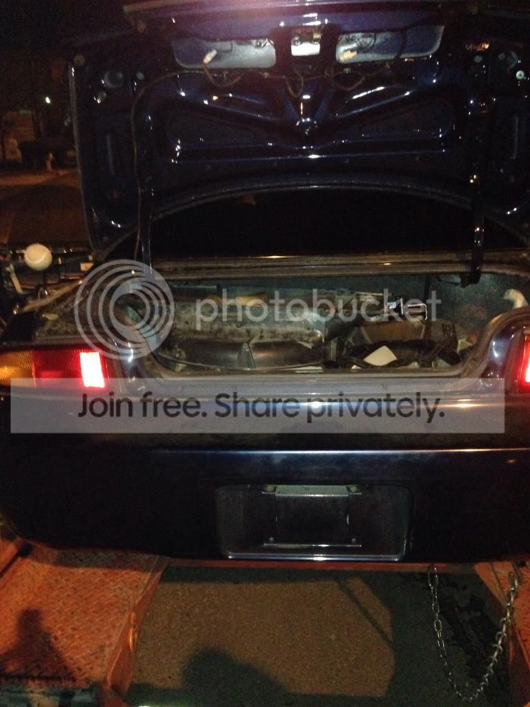

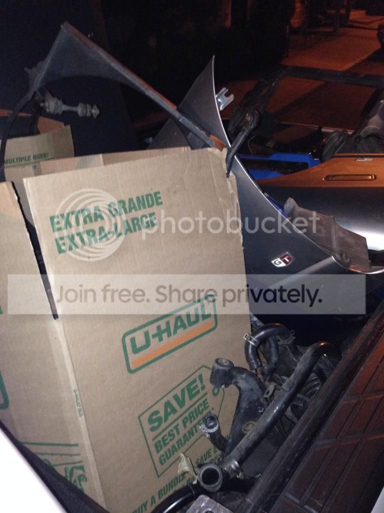

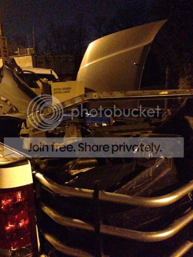

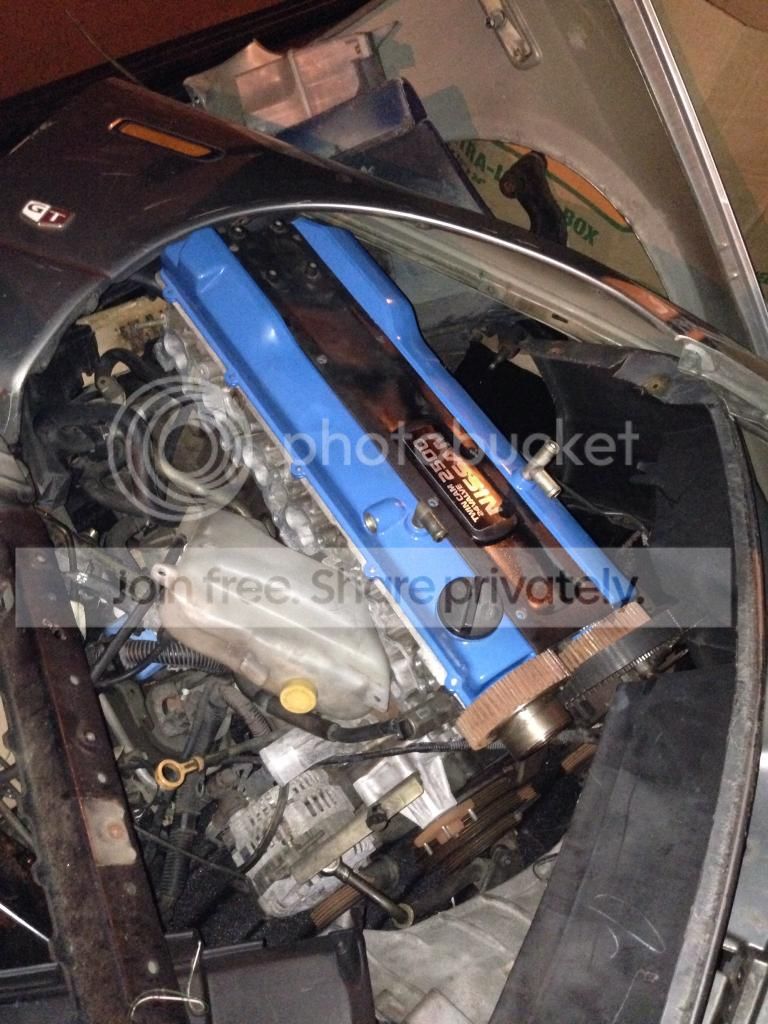

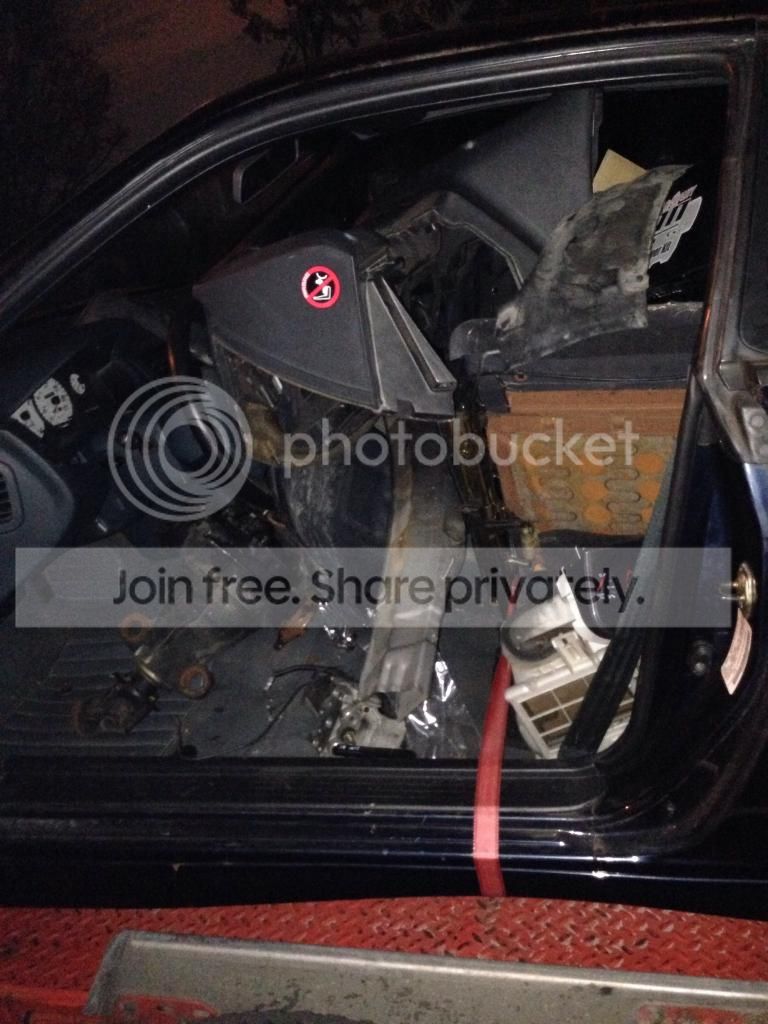

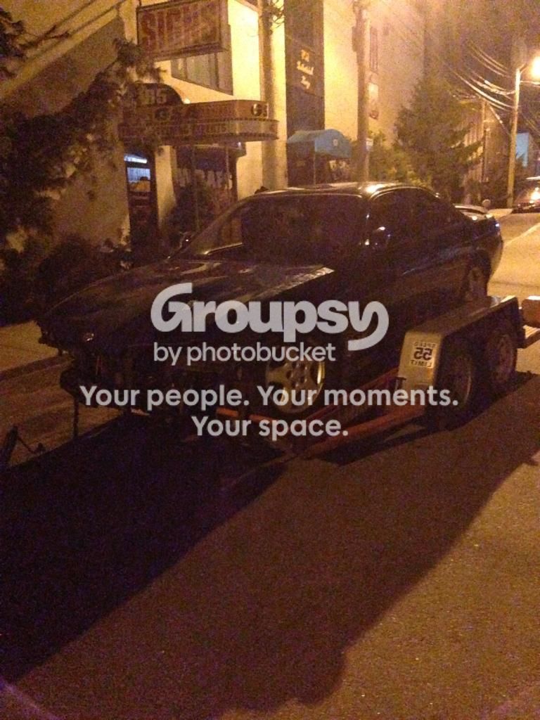

Hoping to have finished product pictures soon but for now some progress pics:
