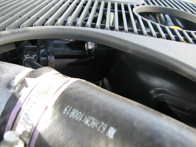

You can just make out the factory bypass valve under the cowl. Another item that will be easy to modify if you want the pssh pssh noise when you lift the throttle.

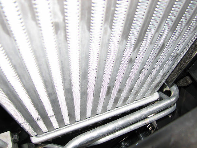

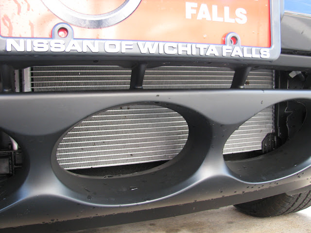

Here's an area that I was disappointed in. The intercooler has plastic end tanks that are basically held on by clips. With increased boost these have the potential to leak. Not something most people worry about, but something for tuners to consider. I'm not saying they will leak if you add a few more psi of boost, I'm just saying it's something to be aware of. There is an easy fix that some people have done on similar intercoolers. You just need to tape off the area with the tabs and seal them with an epoxy. If it's done right it'll hold tons of boost and look good as well. The intercooler itself is a good size and will easily be able to cool 5-8 more psi of boost before an upgrade is required. The plastic end tanks might not even leak, I'm just going on record as saying they could. Also, 5-8 more psi is a rough equivalent to 50-80 hp.
Lots of room for a big intercooler if you do decide to crank the boost up and make the Juke into a monster.

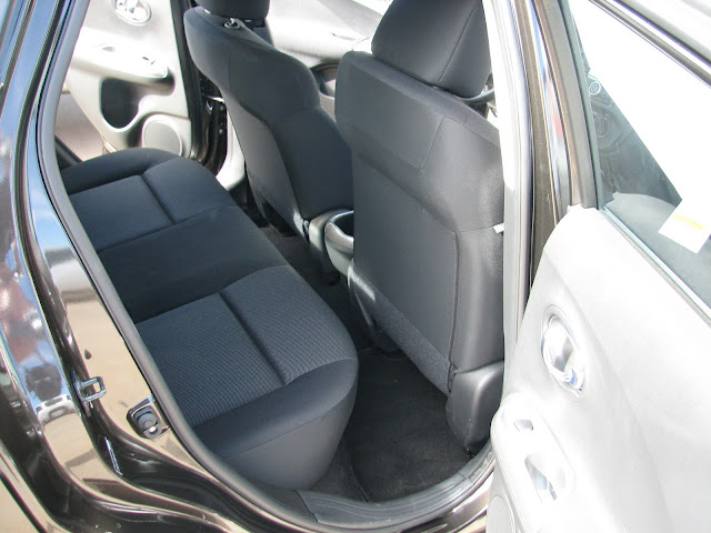

Not a lot of room in the back, again something I already expected.
This is with the drivers seat set for myself, I'm 6' 2".
