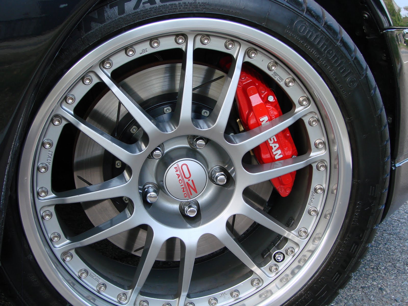

TTkickedin wrote:You have those vr4 rotors right?
350Z Stoptech Track rotors (2-piece), OEM calipers, braided stainless lines, ATE TYP200 brake fluid, 300° BMC brace.
