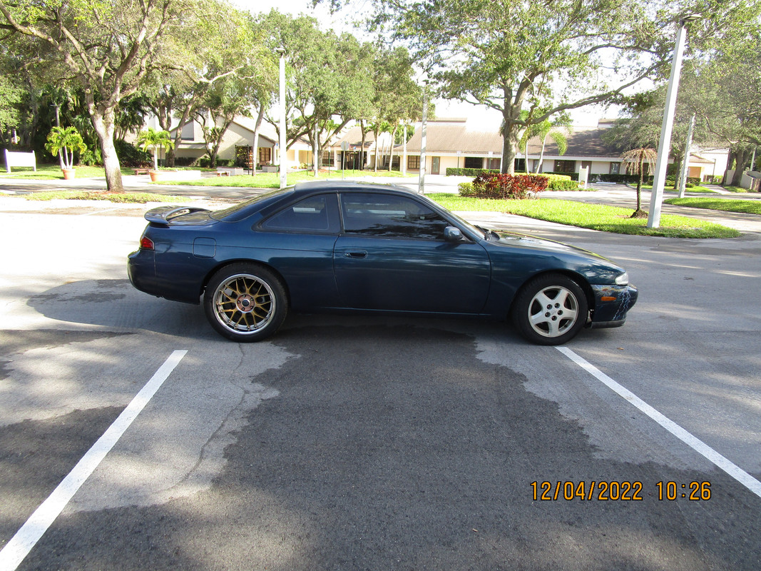

My daily since 2017. I put about 40,000 miles on it since then.
See the white marks at the bottom of the front bumper? I painted it like that to give the appearance of being 'beat up'.
I like people to think its just a beat up old stock 240sx. I get people all the time asking if I want to sell the stock 240.
The paint is acrylic and will wash out with water and a bit of elbow grease. None of the paint on the exterior is permanent.

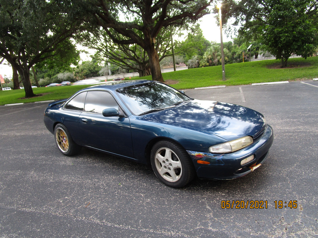

2021 picture last year,
2022 picture, nothings changed except the filter.

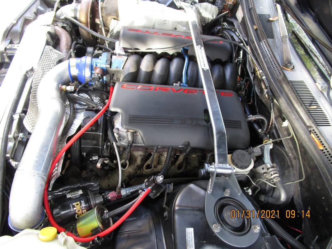

This year it's getting a new high quality AFE filter, Their best for Off-Road filtration.
Fully insulated and shielded exhaust protects everything under the hood and chassis from heat soak. Built to sit in traffic all day long.
Electric Cut-out offers noise and attention at the press of button.
All fuses, wiring and relays are OEM quality. Most have protectivewater proof containers.
I've hidden the main fuse box and taken steps for security.
I've since changed the boost controller and done a bit more tidying.
Dyno day. These engines will last forever at 500-600rwhp.

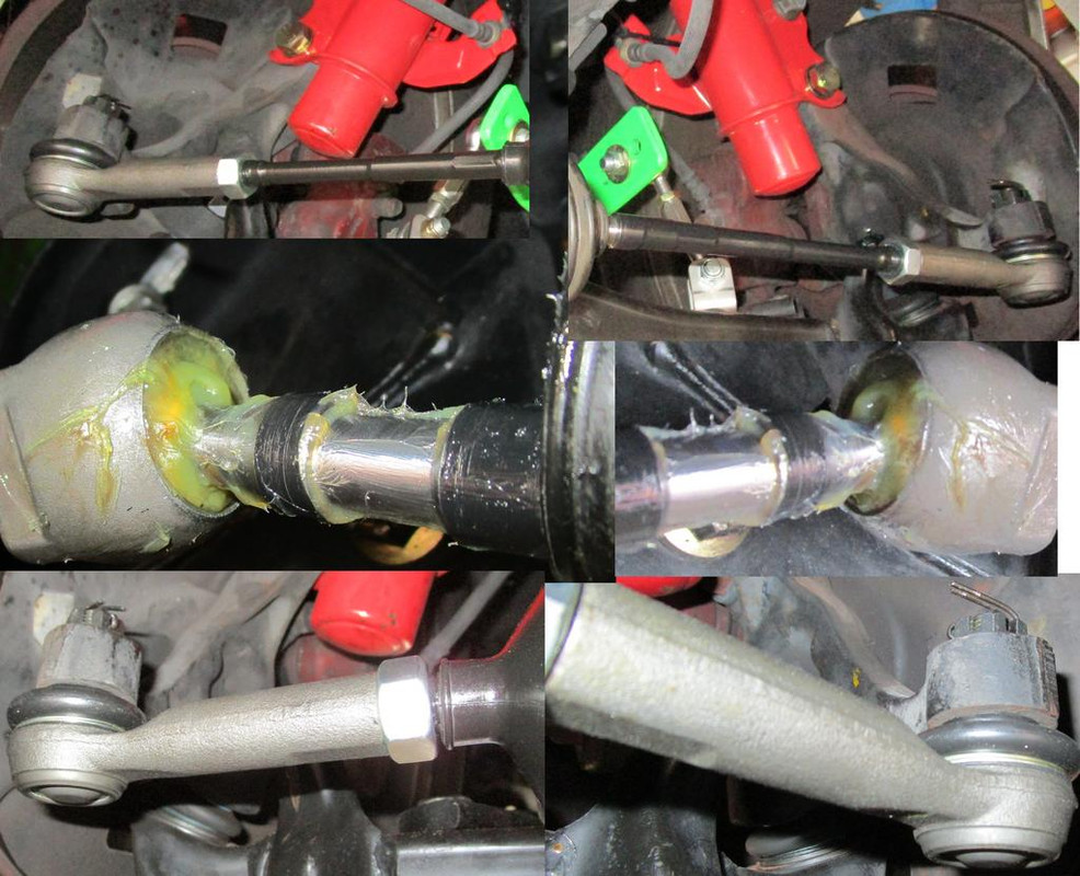

All suspension has been replaced with new OEM quality and I routinely re-grease to keep it fresh.

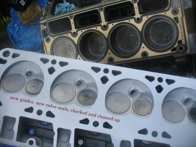

All of the engine's seals and the oil pump were replaced to ensure long service life.
All work done by Factory service manual, torque specsand solvents and procedures.
Fresh set of heads and brand new PAC-1218 valve springs mated to TrickFlow TFS-30602001, a low lift camshaft for long service life.

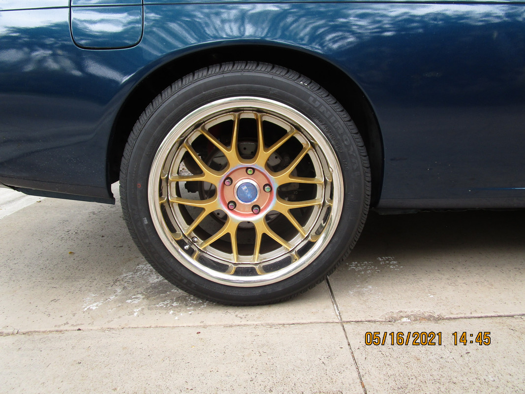

Q45 differential 3.54:1 ratio 32 spline axles, very strong differential supports drag radials. 30mm Brakes of course, stops better than I am used to even for a 240. The brakes and rotors are new from RockAuto, not used from an old car.
