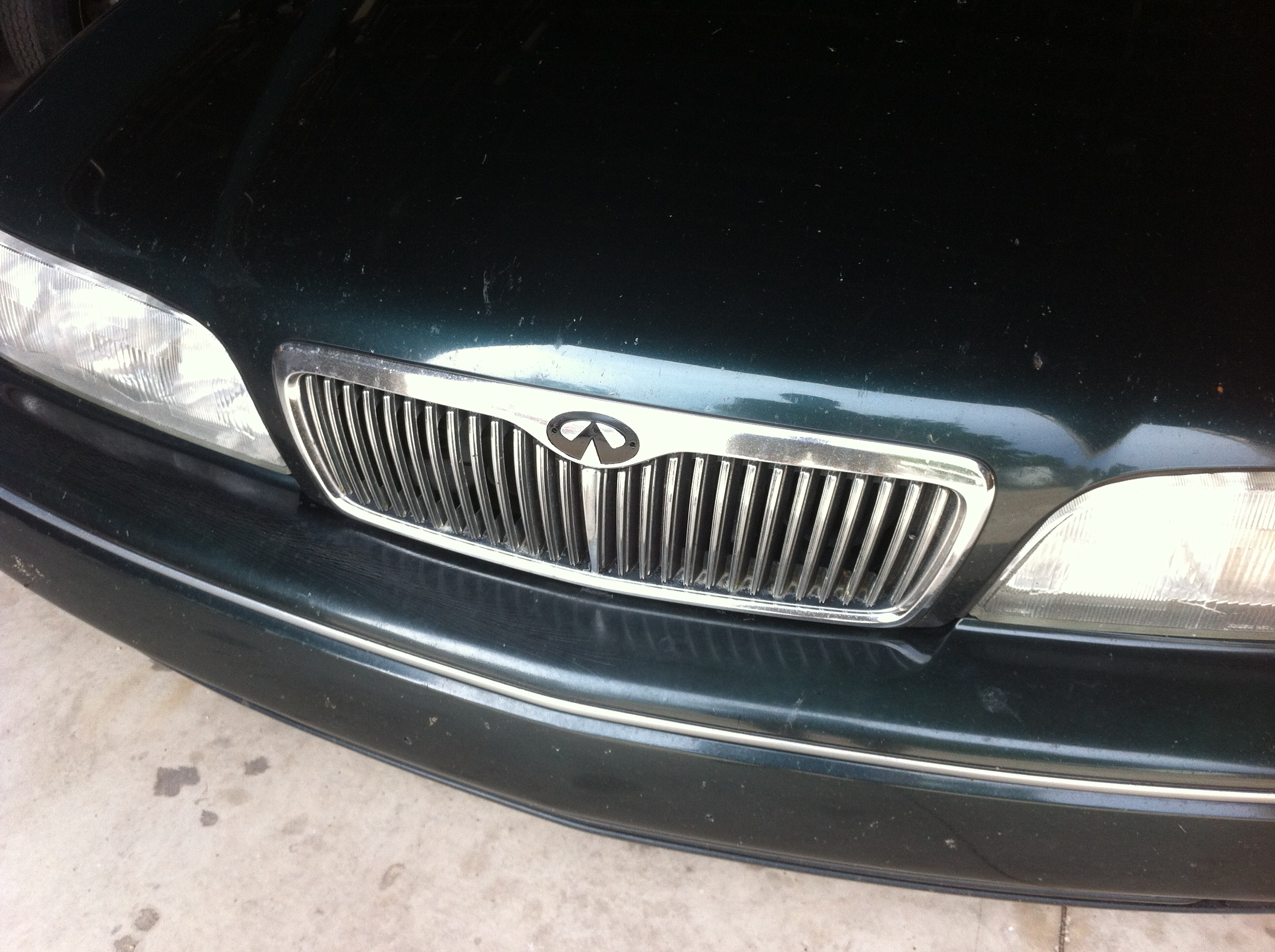

First little thing I did was I painted the infiniti logo on the front grille. I noticed that the little plastic infiniti logo that is embedded into the grille was missing, either from someone prying it off or it falling off. I think it falling off could be likely as there was no sticky stuff left behind. In any event, I masked it off and shot it with some black. It looks better than it did, although it looks kinda funky with the two holes that were used to hold the logo on.

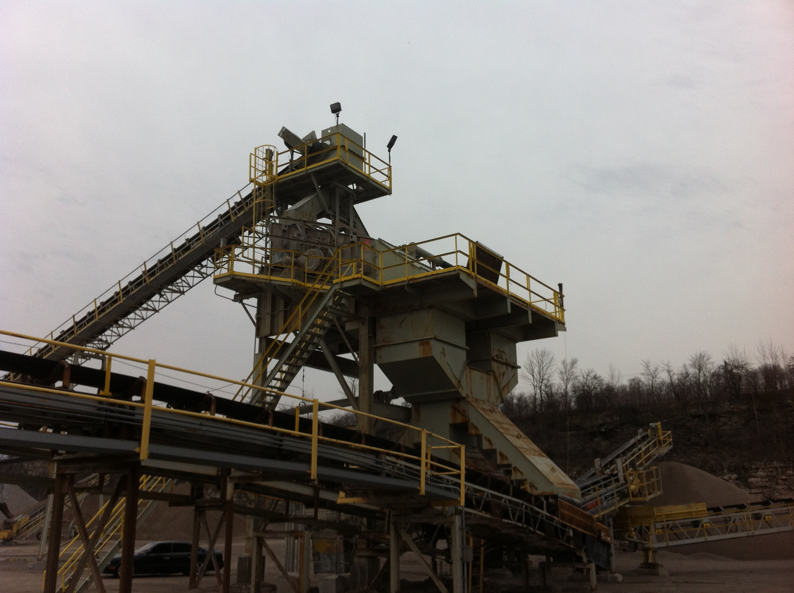

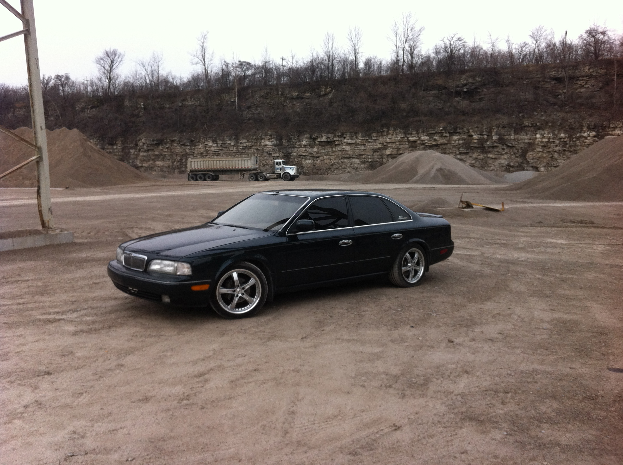

This picture was taken at a rock quarry I visited this past March for work.
This is a shot of the machines my company makes, large rock shakers mainly for sand and gravel. Notice the Q in the lower part of the picture.

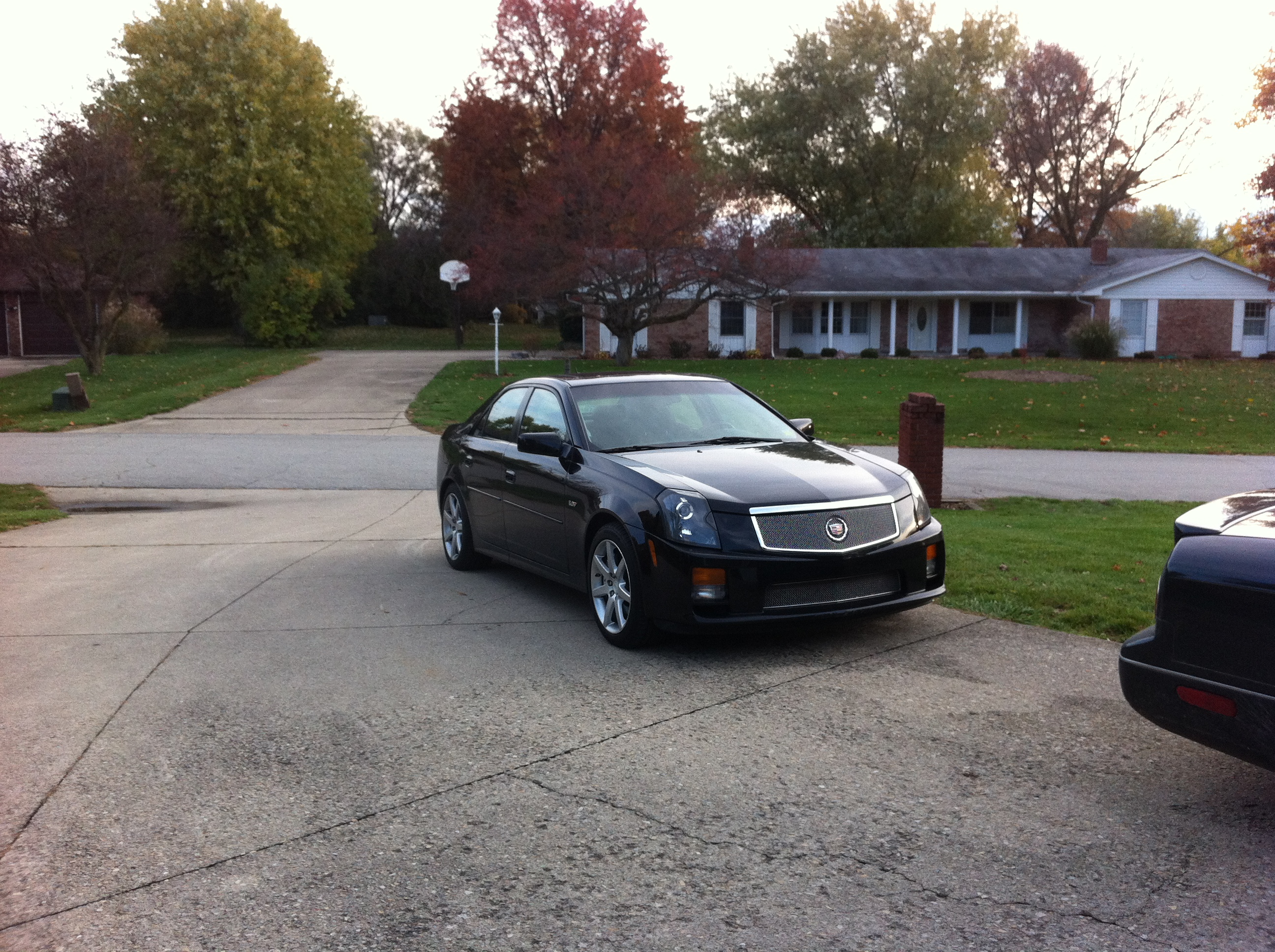

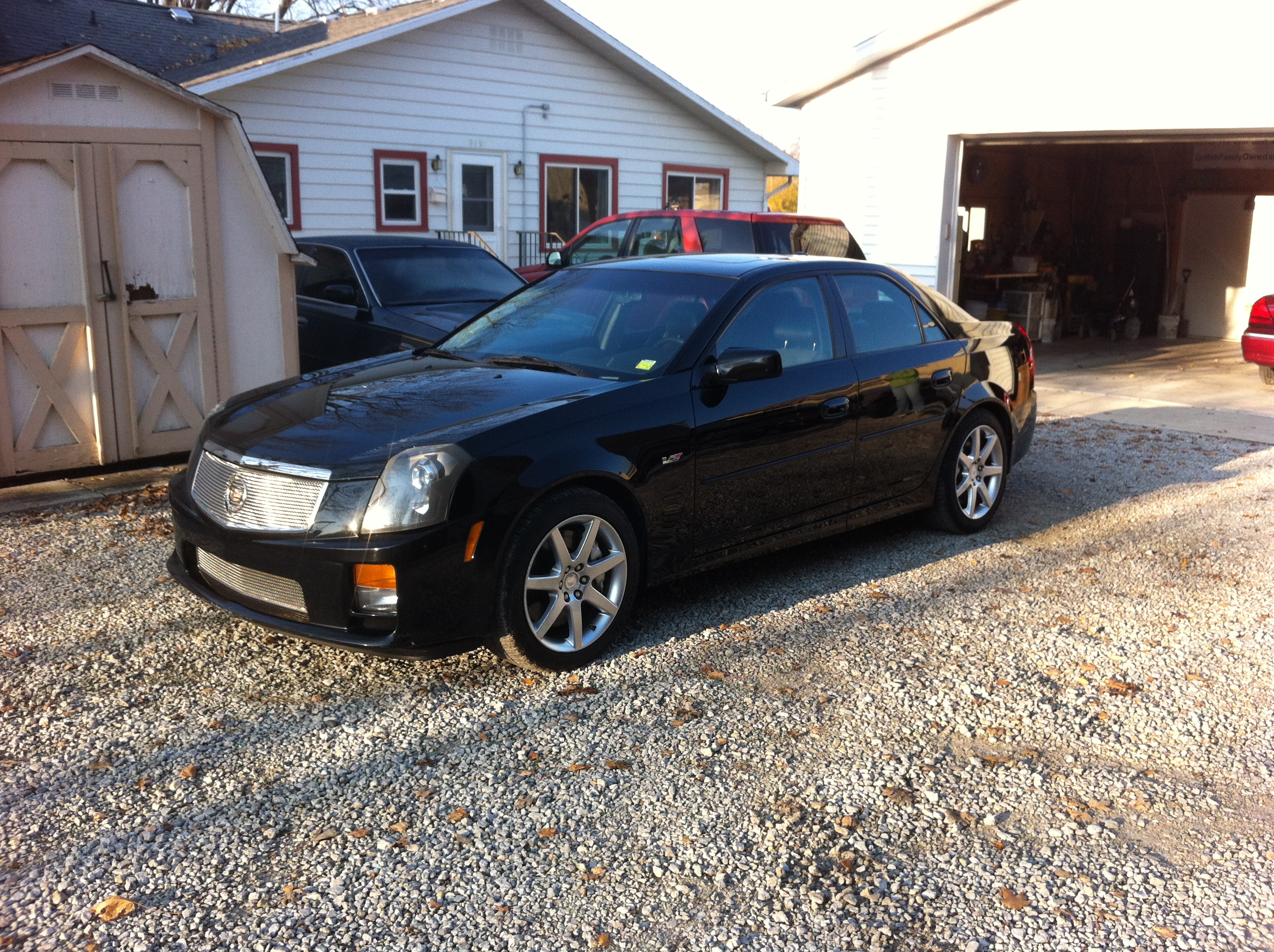

Here's a couple shots of my CTS-V
