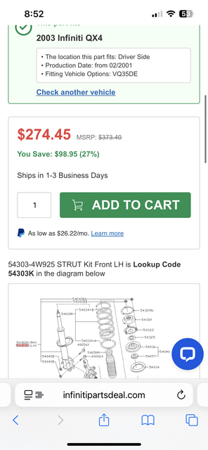

Being I can’t find any complete kits that aren’t lowered coilovers, I’m getting eager to find something that may substitute it. I’ve looked up models like the QX4 and FX models that have a few aftermarket assemblies, without the spindle. Which is what I need to essentially bolt it onto the existing one.
Having to compress the springs to take on/off adds extra cost. I get away with the rear ones like that, but the fronts have a lot of weight.
I’m on the sites to see if there’s matching upper strut mounts, that way I can find the best fit. Anyone open to help find some that may match? I don’t have active suspension either so hopefully I can get around it.

Here is an example of what I refer to. Infiniti parts shows a picture of a q45 strut without a spindle. And it also shows a QX4 that can be ordered without a spindle. I would probably use a different seller like on eBay that includes the whole spring and mount kit. But there does seem to be a difference in weight and dimensions, but I don’t know if that’s due to the weight of the spindle hmm…
