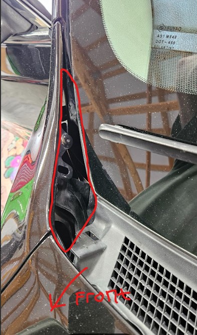

It looks to me like there are missing pieces around the bottom of my windshield. Its in the upper corner of my fender and air intake thingy. I looked on Nissan OEM site, but could not find this part listed. Can anyone tell me a part number for this? I need both left and right side pieces.

For some Japlish reason known only to Nissan, they decided to put those covers on the fender drawings and not the cowl or windshield. They're 66894M and 66895M in the legends here:
https://www.nissanpartsdeal.com/parts-l ... m=630_A003
The early ones were infamous for embrittling and falling to pieces, there was definitely some sort of materials problem. For a '16 your numbers should be 66894-4CL0A righthand, 66895-4CL0A lefthand.

Found a set on Amazon using those numbers. Listed as "Cowl extension trim" there.

Got the parts today from Amazon. They are close, but I could not get it to stay on.
:nono: Don't waste your money on these. :nono:
I will be ordering the OEM parts.
