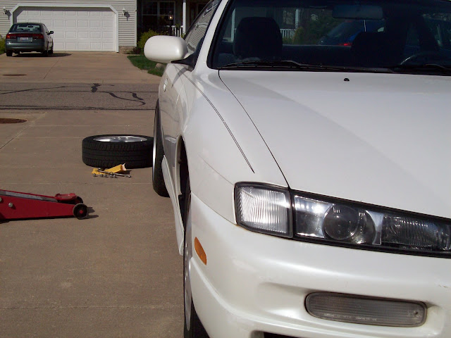

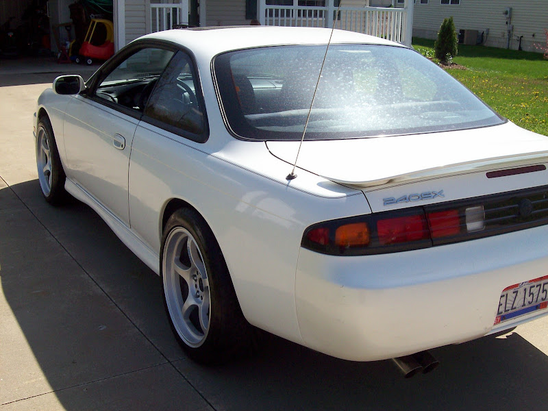

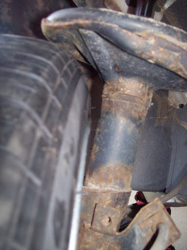

So I got two of the tires mounted on two of the 18x9.5 rims.
I test fit them on the front and they just barely rub.. top of the tire on the bottom of the stock strut (the cradle where the spring sits). Just barely... I found a set of 245/40 tires locally for dirt cheap, so I think i'm going to pick those up.. that 5mm of extra space should be enough I think.

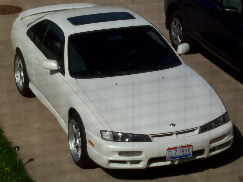

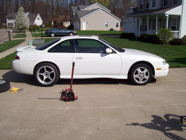

Here's a couple pictures of the 18x9.5 on the rear...
I know.. it's too much tire.. a 35 or even 40 series would be much nicer. But again, I'm not really spending any money on this, just using stuff I already have in my basement.
I did buy a set of lowering springs however.. 1.2" front and 1" rear drop.. should be just about perfect.. for me at least... I'm already worried about those being too low.

You are going to want some stiffer shocks on those springs, might as well do it at the same time, instead of doing mulitple swaps/alignments. Just some Tokico Blues or something to save money (they've been good on my Vert).
Looks like you'll have to have more camber and/or roll/pull on that rear fender after springs. May even hit at stock height on bumps right now.

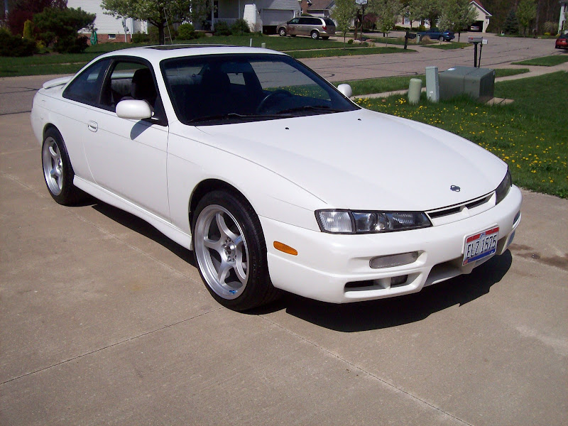

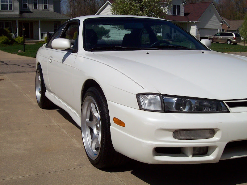

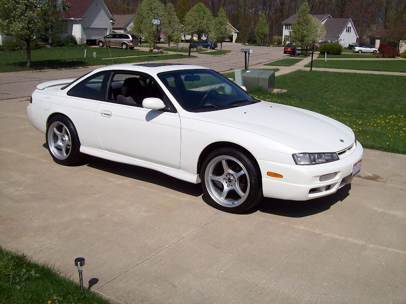

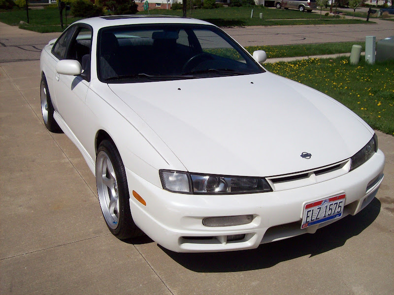

Update on the wheel fitment:
From my last post, I've been trying to figure out wheel/tire fitment using the GramLights from my basement, and the tires from my basement. I got a pair of the 245/45 tires mounted, and they fit fine on the back, but were just a hair too much rubber for the front.
So I've been watching craigslist... found a set of 245/40/18 Michelin Pilots with decent tread left on them for $80 total. Score!

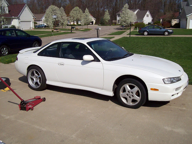

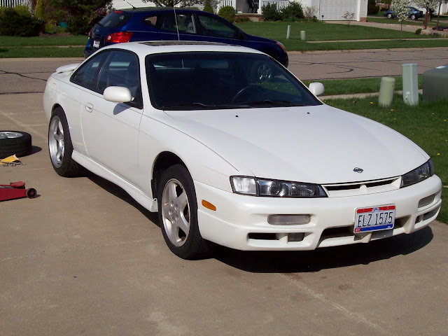

I got two of the 40 series tires mounted on my other two 18x9.5 wheels and test fit them: Close fit huh?
They only rub a hair on the fender liner plastic when turned sharp... not a big deal!
So I threw all the wheels and tires on and now my Kouki has new shoes!
Future modifications include: Lowering springs (and probably struts as well), brakes, exhaust (you should see the ridiculous patch job someone did on the stock muffler... i'll post that pic another time.)
Total mod money spent so far: $150 ($80 for the set of 4 used tires and $70 for mount/balance at the local tire shop)

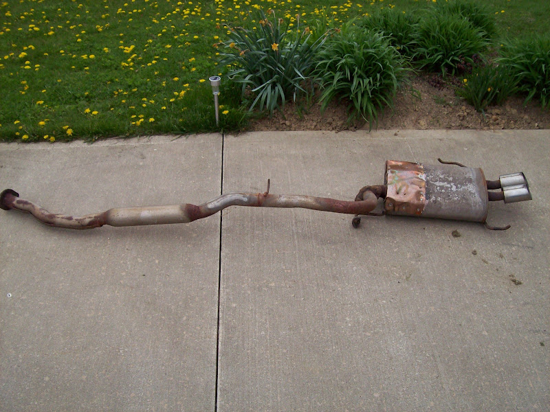

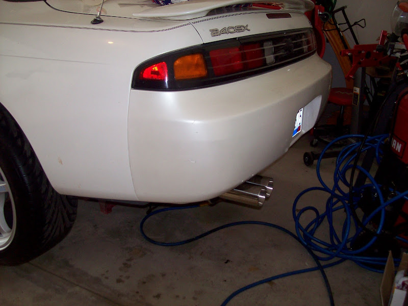

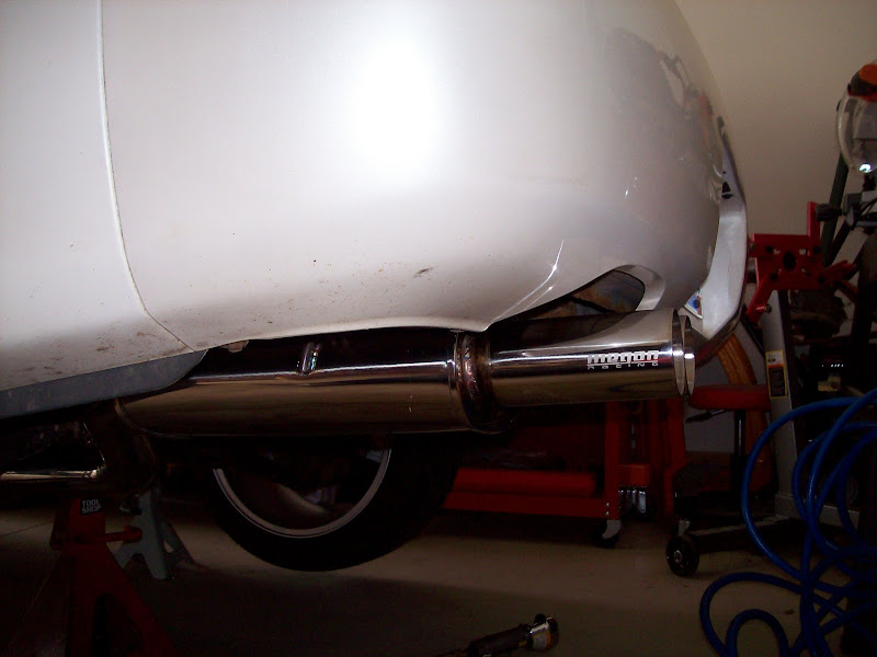

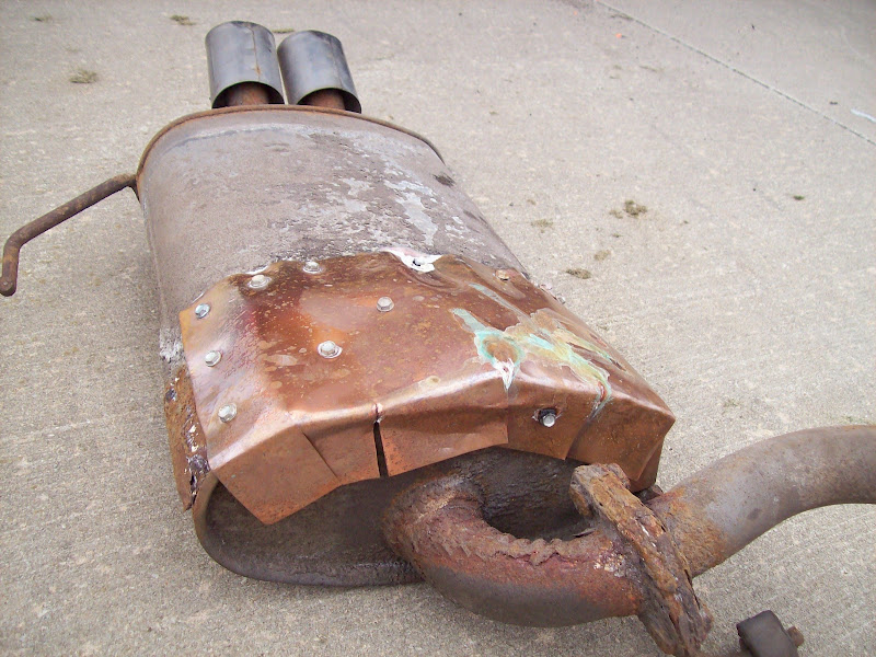

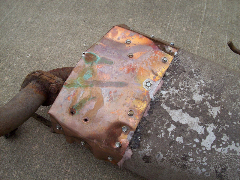

The patch job on the muffler on this car is unbelievable!!! Check this out:
Yes, that was insulation sticking out (pink stuff).. what a rediculous piece of work!
So I replaced it with this: Megan Racing Type 2 exhaust. 3" throughout (yes 2.5" is best for the KA motor, but it won't always be KA.. I'm just planning ahead).
The fitment is nice.. not perfect, but very adequate. I have a little sound in the rear if I hit big bumps.. not sure if that's due to the exhaust bumping on something or the rear wheels rubbing on something.. I'll investigate that another day.

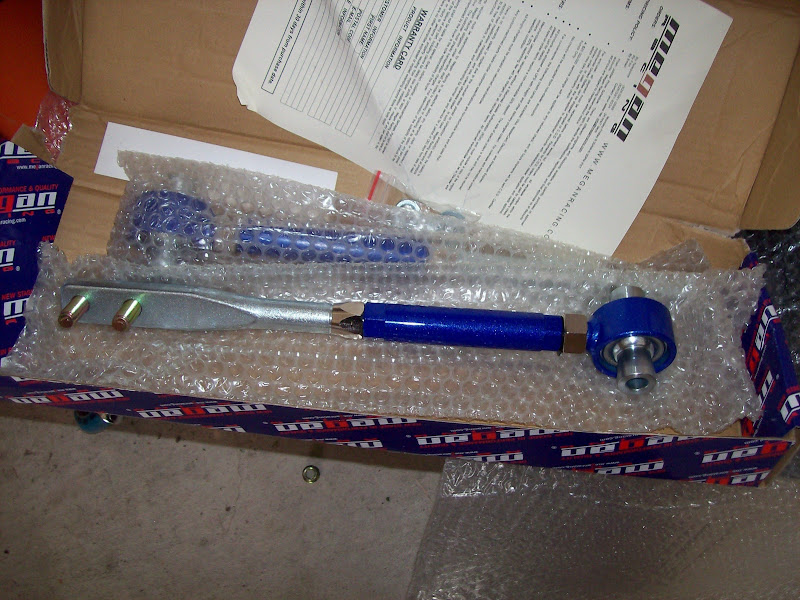

Next project: Front pillow ball TC rods
