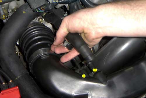

so i used some universal piping laying around my garage and i decided to make a nice looking CAI... heres a pic...
thought i was all done so i went to start my car... chug chug chug, it wouldnt really start... so itried again and opened the throttle a little and it started up... barely... it was idleing rough and i revved the motor and it stalled....
now the stock inake piping has some hose runnning off of it... one to the valve cover (mine has a filter on the valve cover), one to the Idle air control valve and one smaller hose.... i noticed that i forgot to hook up the little rubber hose to the intake. i tried to follow it but i couldnt figure out what it lead to... would this effect my idle and dose this need to be hooked up to the intake? here a pic of the small rubber hosing that im talking about if it looks familiar
what exactly is this for? thanks in advance dudes and dudettes! :crazy:
EDIT: BTW.... in order to get the maf sensor to plug in i have to extend the sensor wire like 2.5 feet.... could this be why i have bad idle?

by the way... the tubing im talking about connects to the smaller of these two nipples on the stock OEM plastic intake....

Im pretty sure those lines run to your charcoal canister. Just cap it all off.

No but a huge vacuum leak will cause bad idle conditions. Also the tube you have you're hand around is the tube for idle, on your new intake setup it must be that same diameter otherwise your car won't have enough air to breath and die.

figured out what it is... if you look in the second picture behind the tubeing that im holding you can see the clear hosing thats connected to the IACV... turns out it was pinched a little bit and wasnt letting the air come through that good... problem solved :dblthumb:
