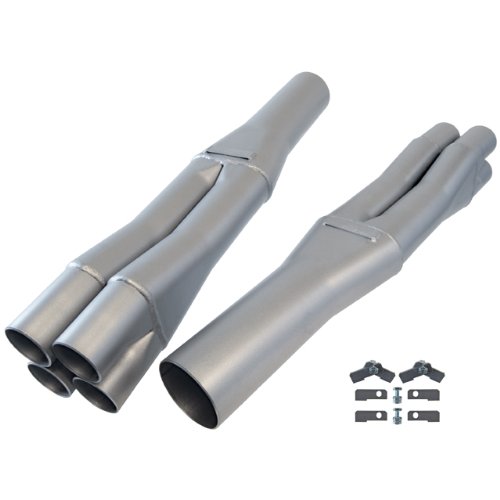

Yellow4g63
Posts: 3718
Joined: Mon Jan 20, 2003 6:07 pm
Car: 95 Nissan RB20 240SX RB20
91 Nissan NX2000 VE power
95 Nissan 240SX Stock
I thought they only sold the slip fit on type of collector.
Image does it look kinda like this one?
LEMHEAD16
Posts: 1769
Joined: Tue May 06, 2003 3:58 pm
Car: '12 Genesis Coupe
'95 QofDOOM
'56 Chevy pick up
Location: Boise, ID
More like this, except smaller inlet.

great idea with the tri-y collectors, thx. looks like they're exactly what i need to keep the exhaust away from the ground. Also theyre good for torque :)
