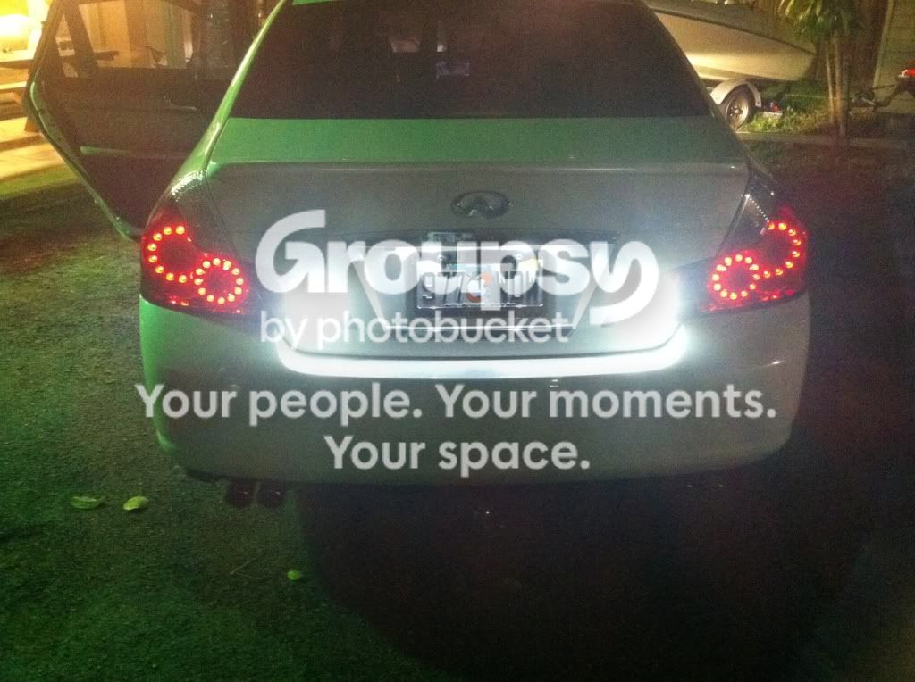

sidemarker with 194 white no yellow:
06M4.5
Posts: 2478
Joined: Thu Sep 09, 2010 6:04 am
Car: 2006 M45
Location: Florida
06M4.5 wrote:this pics shows lic plate, back up & blinkers
this pic shows blinker & parking lights
and this shows side marker on fender (NO YELLOW)
I like it all white
