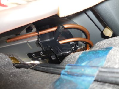

I just dealt with this tonight... was getting water running down my a-pillar after heavy rain. I pulled the headliner and found this
You can see towards the left of the picture above the drain tube was basically smashed completely flat by the headliner. I had to stick a dowel in there to open it back up. It was stuck with crud and mold.
I opened it back up as best I could and put some zip-ties on it which I hope will help keep it open a little bit. I also tried to route it closer to the door opening than where I found it which was basically going straight from the nipple towards the front of the car.
