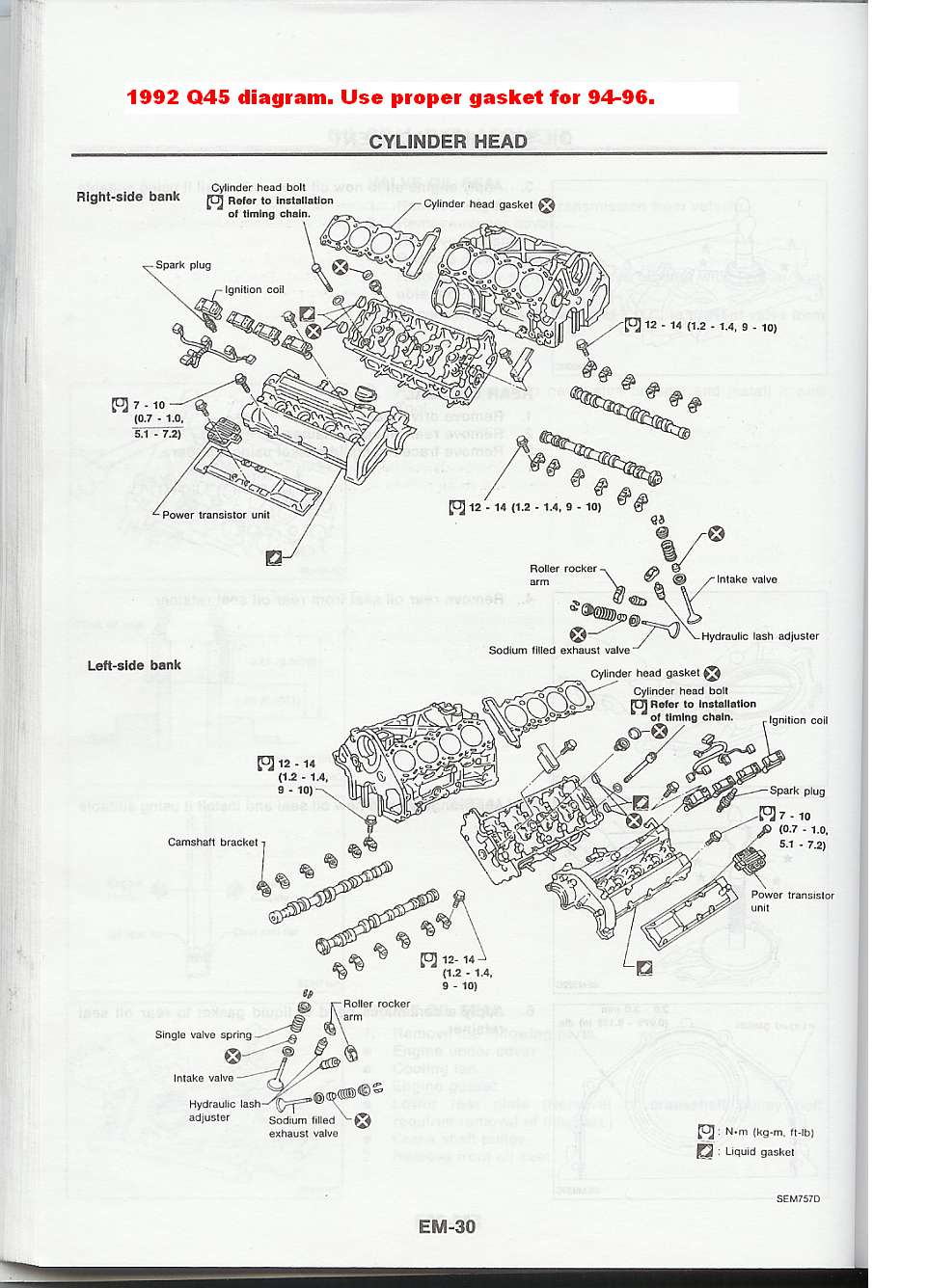

Joe's Prices1. Valve Cover Gaskets $10.69 each I need 2 of them2. Power Steering Rack Boots $13.01 each I need 2 of them3. Pulleys $41.90, $30.24 and $36.41 for all three pulleys, I'll be doing that myself
http://www.q45.org/vc1.jpg
Looks like it involves removal of the cover that goes over the coil packs, the power transistor, the coil packs themselves, and all the wires.
