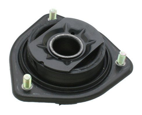

The camber is not adjustable on the J30. The point where the top of the strut mounts to the chassis would be the adjustment point if the J30 had one.
Like this:
The J30 is like this:

Hmm alright. Any knowledge of any aftermarket kits or anything? How off one is from the other is too much of an issue to not correct.

trissdv wrote:...How off one is from the other is too much of an issue to not correct.
That question is outside my scope of knowledge. Maybe if you post up your alignment specs someone more knowledgeable will chime in. I don't think there are any kits either.
An option would be to install S14 steering knuckles which would give access to may different coil-over setups with camber adjustment, but you are taking a major investment & modification.

I wish i could find that adjustable top hat.
My camber is way negative and its heck on the tires.
Figure my only option is new springs.

fronts you can use EVO 8 camber plates and the rear is not setup like a 240z. you use these control arms in the rear is you are serious about adjusting camber: https://www.splparts.com/store/product- ... id249.html
