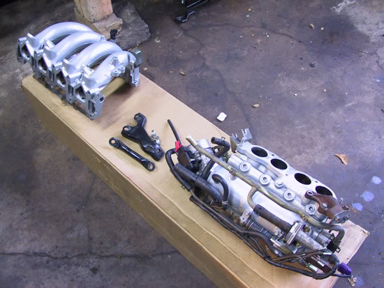

Upper portion is on the left, lower portion is on the right. In between is the mounting hardware for the manifold. Note also that there is a gasket that fits in between these two parts (Advance Auto has both intake mani gaskets - this one and the one between the mani and the head - for 6 bucks).

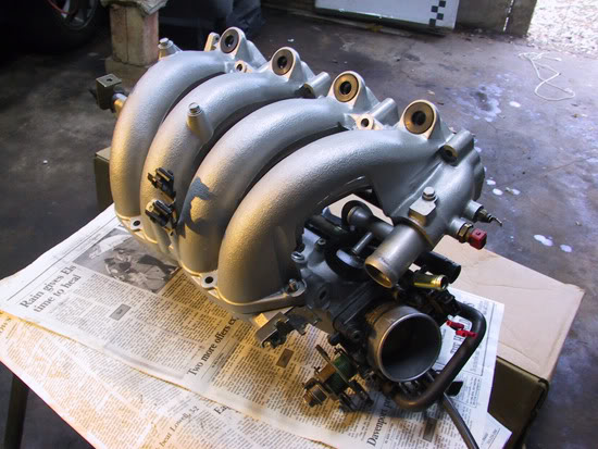

The finished product for me:
Note that I did not include any information on the fuel lines. This is because I used a custom top feed rail and line setup on my engine, so I don't really have too many pics and info about it. Basically the fuel feed is on the front of the rail (comes from the filter), and the return and fuel pressure regulator is on the rear of the rail (which goes to the return line, of course). You don't have to keep the stock system the way it is, but you obviously cant remove it completely either. Picking what you want to do with this is a matter of preference.
Well thats just about it! I'm sure I missed a thing or two and I may be incorrect once or more than once haha... So any questions feel free to ask, and any corrections feel free to post.
Also for those who are interested, the manifold finish is Duplicolor Cast-Coat Aluminum (500 degree) rattle can paint. I recommend it highly for people looking to refinish their manifolds without getting too crazy. I went from this:
To this:
With just some engine degreaser, wire brush, a couple coats, and some dry time. Very easy and it looks pretty nice.
