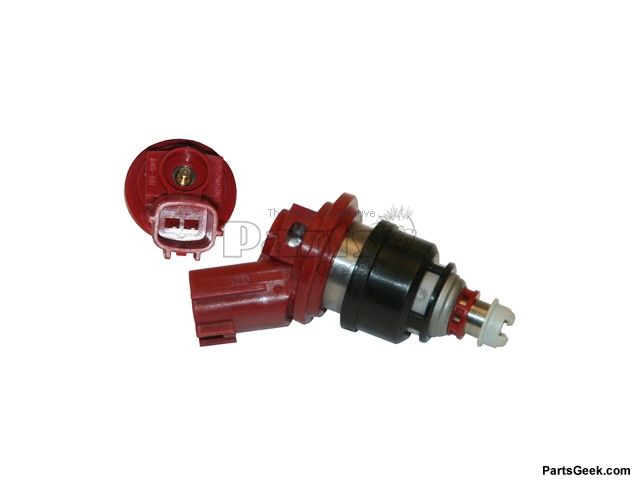

For whatever reason, the injectors from your pathfinder look like this:
And most of the injectors from other cars (J30, 300zx, Maxima, Altima, etc.) look like this:
However, it looks like newer injectors from a VG33E engine (found in newer pathfinders) will fit. In order to do this you would have to swap out all of your old style square connectors to the newer style oval ones (you can find these in almost any 94+ nissan car/truck at the junkyard). There's 2 wires for each connector, you just cut the old one out and solder in the newer ones. These will also last alot longer than your current old style ones.
