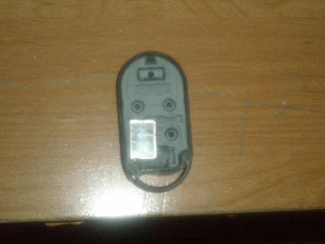

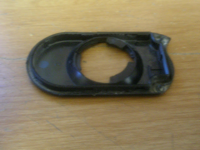

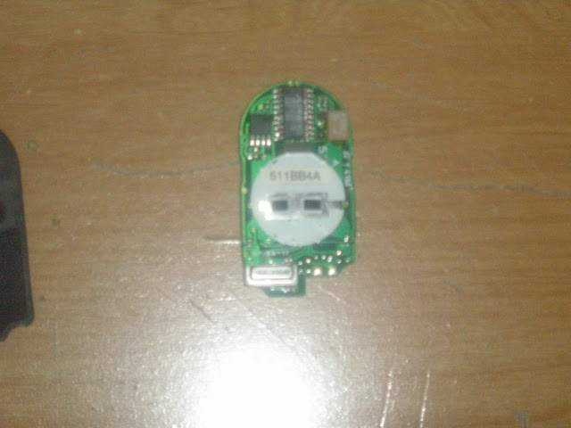

http://picasaweb.google.com/lh/photo/mC ... directlink

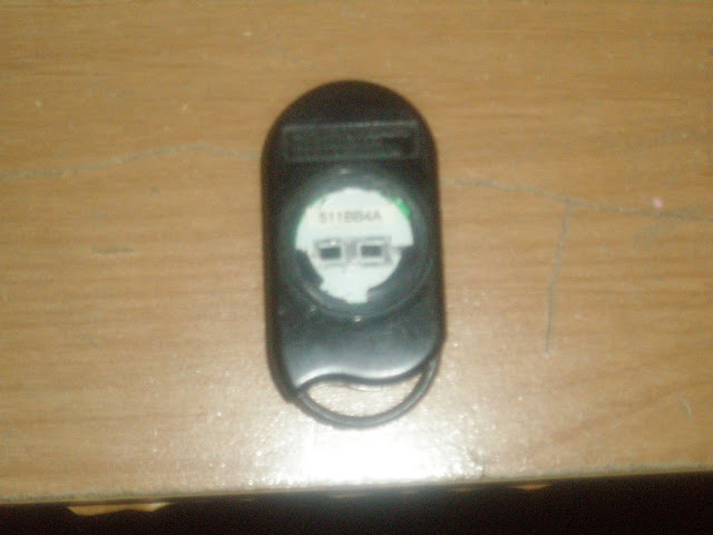

http://picasaweb.google.com/lh/photo/Cz ... directlink

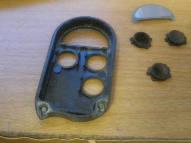

http://picasaweb.google.com/lh/photo/ty ... directlink

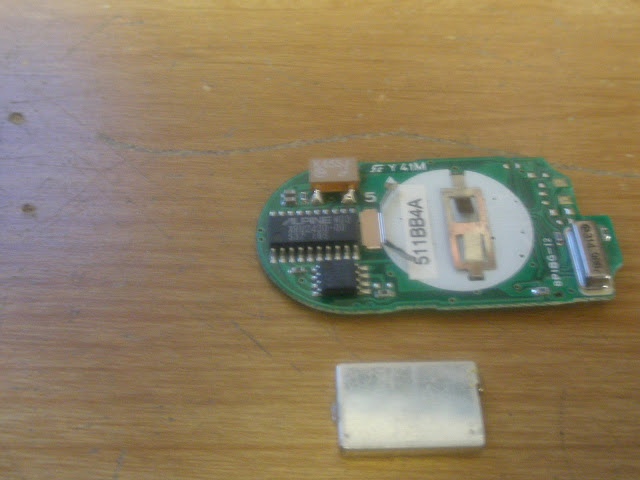

http://picasaweb.google.com/lh/photo/U0 ... directlink

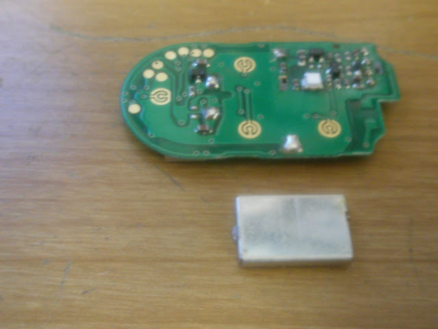

http://picasaweb.google.com/lh/photo/sf ... directlink

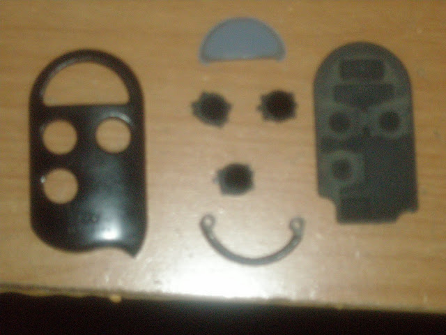

http://picasaweb.google.com/lh/photo/AG ... directlink
http://picasaweb.google.com/lh/photo/sM ... directlink
http://picasaweb.google.com/lh/photo/MB ... directlink
No getting away from the fact that Alpine supplied the alarms for the J30. Can't find any evidence of that on the 1994-1996 Q45 keyless entry control unit. Thats not a bad thing though because I read that Alpine supplies alarms to BMW as well. http://www.nicoclub.com/archives/oem-af ... parts.html.
I will sell or trade the key FOB because Jspout (The person I got the keyless entry parts from) said the remote and control unit were the same FCC ID. When I received I the parts I checked to be sure and he was wrong. The remote show ends with a 73 and I need one that ends in a 72.
And Qship these topic here may help explain a little eaiser why your keyless entry works better from a taller building: http://action.publicbroadcasting.net/ca ... 59610.page
http://ezinearticles.com/?Improve-The-R ... &id=268916
They also say soldering a wire to the antenna part of the transmitter will help range, Any truth to that?
If so what part is the antenna?
(My guess is the silver tiny sardine can on the 5th picture to the far right).
They also say using a bigger gauge wire for the antenna will help a little (Less resistance)?

Ideally at 315 MHZ an antenna should be a 5" rod [1/4 wave length]........the impedence match changes with deviations +- from 5". Inductance [coil] is series to lengthen the effective length and a capacitor to shorten an overly long than 5".
The wire can be bend into angles.
I would expect the hand transmitter is already optimized whereas the receiver antenna may need some work............maybe a mast or tower up from roof center to gain elevation if you decide not to add a low noise preamplifier.
