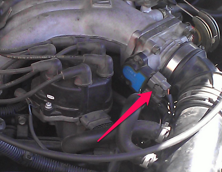

Do me a favor - Unplug the marked sensor and start the truck. Let us know what it does. NOTE: It won't rev up or anything, but it should start.

There's no image. Plus I have the manual downloaded on my laptop. I was wondering if when the mechanic did the knock sensor last year do you think they could have done something to the intake manifold? Like miss a vacuum line or something. But the only problem is, is that it ran great after the knock sensor was replaced had no power though but like could he have missed something do you think?

Pic fixed.
