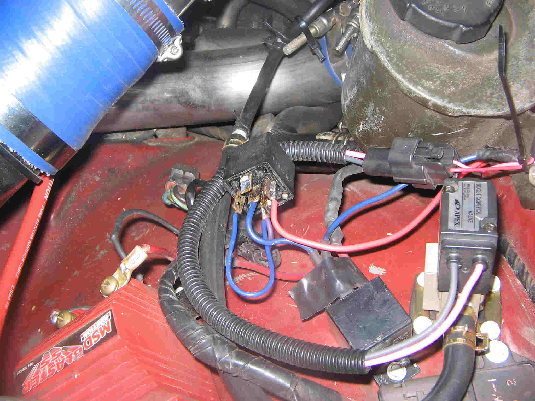

Number one: Clip your stock positive coil wire(black with red stripe on both S13 and S14. S14 guys, you will have to look near the distributor cap to find it/and prolly have to run a little more wire to wherever you choose to mount the relay) and strip both ends. Run the ECU side of the coil wire to pin 30. Run the coil side of the positive ignition wire to pin 87a. Solder on that 16 gauge piece of wire to pin 85 or 86(doesn't matter as the relay coil is not polarity sensitive. Make a small "jumper" out of a piece of 16 gauge wire and run it from pin 30 to pin 86 or 87(doesn't matter as the relay coil is not polarity sensitive).

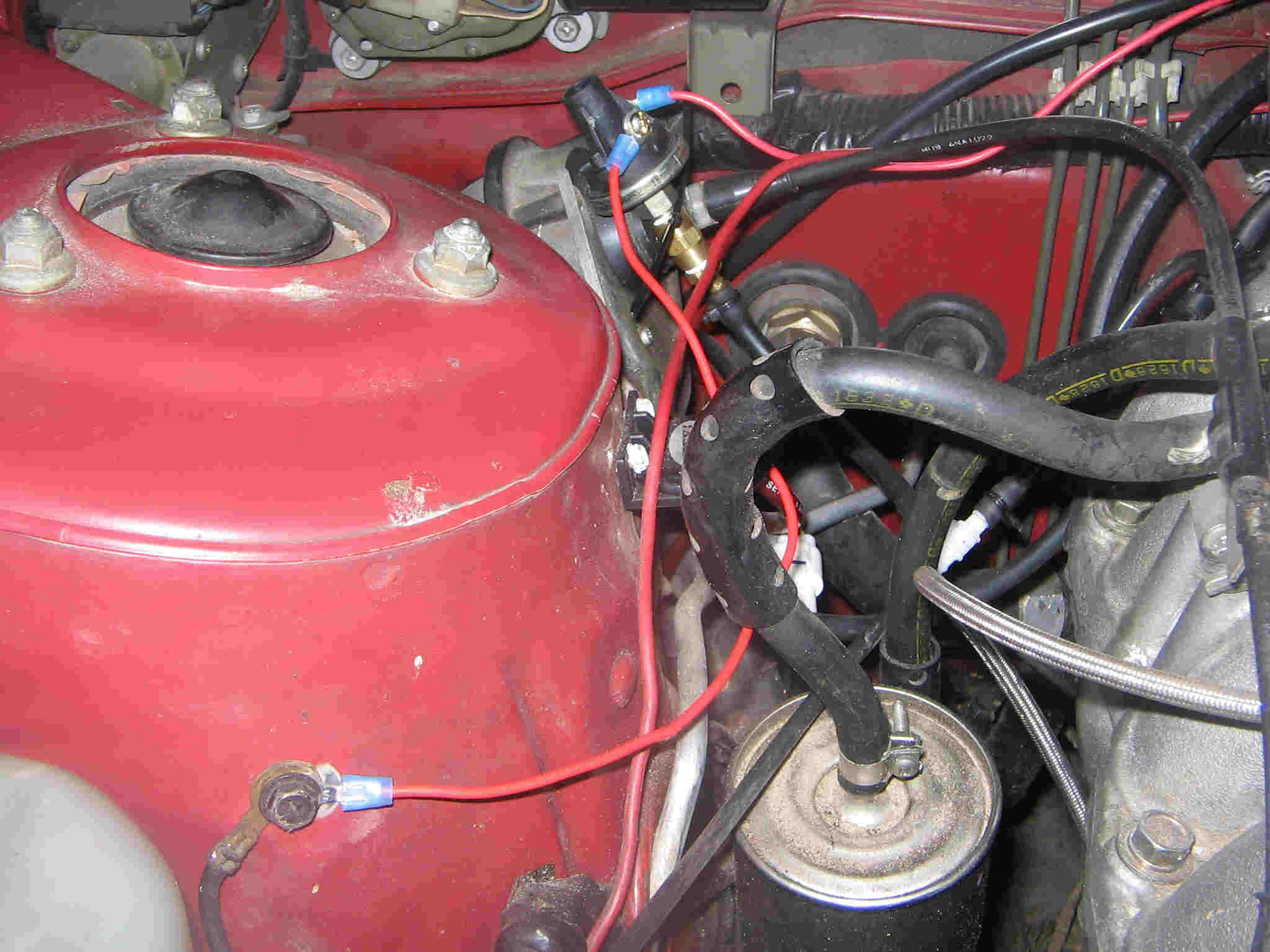

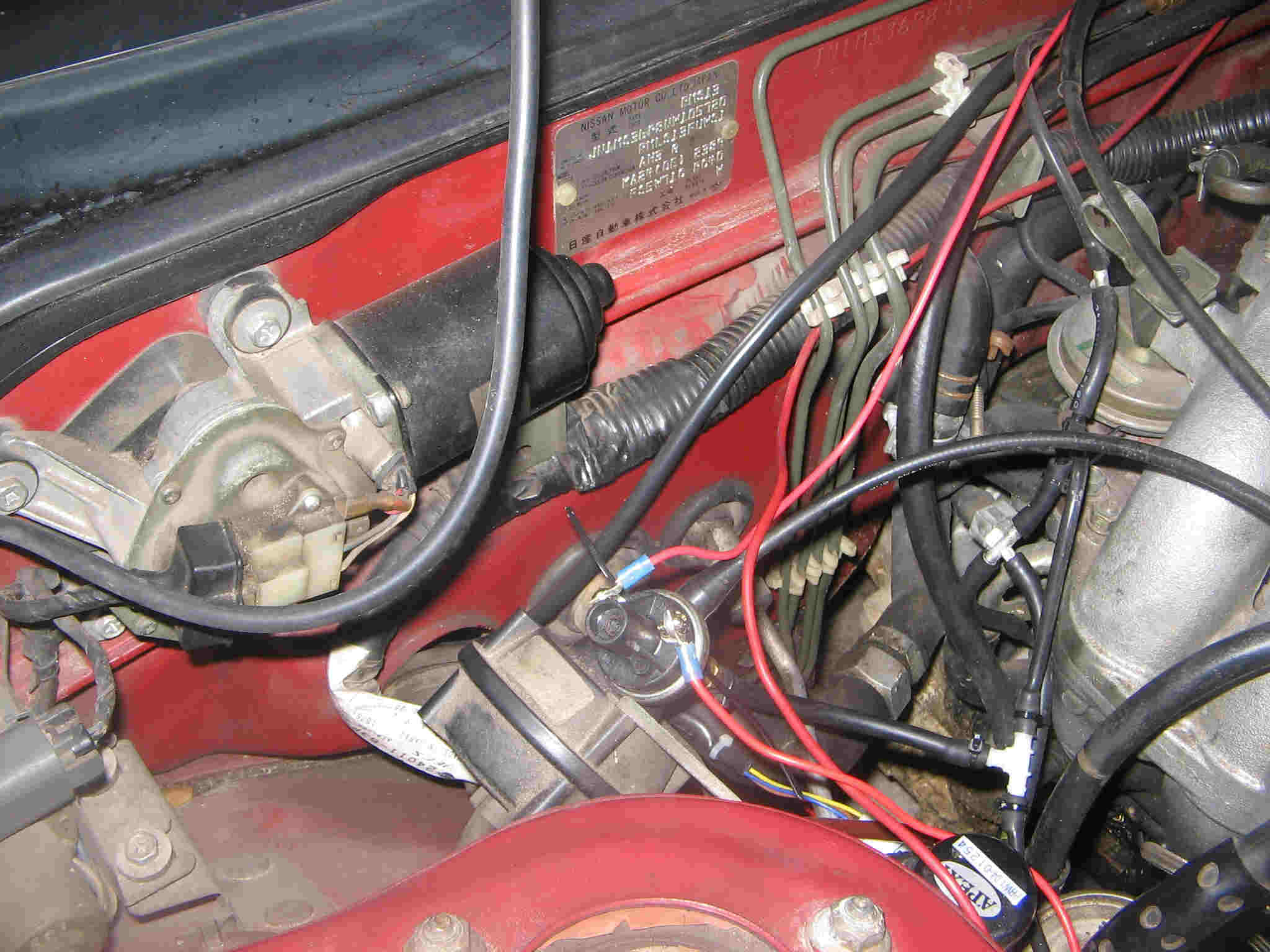

Number two: Run the 16 gauge wire from pin 85 or 86(whichever you chose) to wherever you plan on mounting the Hobbs pressure switch. I recommend putting it near the intake manifold to get an accurate pressure reading on what is entering your engine. You'll need to set the Hobbs switch approx 2psi higher if you use a hotpipe boost source. But I wouldn't recommend that as the Hobbs switch box clearly says to avoid high heat. I mounted mine here:
Number three: Find a good ground point. Run some 16 gauge wire to that point and ground it using a crimp-on connector. I used whatever that ground is on front of the passenger side wheel well. Sand the contact point well.

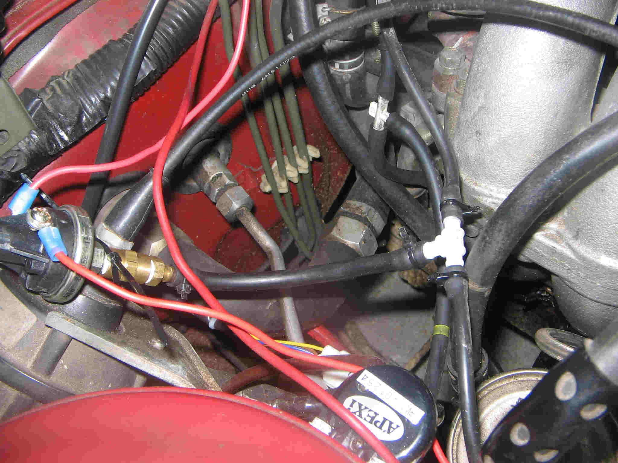

Number four: Tap into a good boost source. FPR line is probably your best bet.
Number five: Crimp the connectors onto your ignition tap wire and the grounded wire and connect them to your Hobbs switch.
Number six: Remove that rubber plug on top of the Hobbs switch and tune it. I removed the vacuum line from the intake manifold and used an air compressor. But in order to do this, you must have a multimeter and use the method I described above. If not, you will more than likely need to do trial and error.
