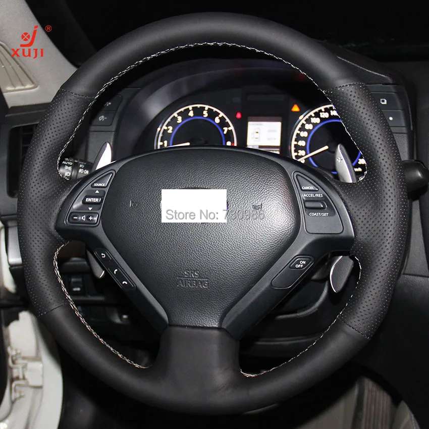

The coat rack is not part of the tech package. It is part of the touring package. The tech package will have two extra buttons on the steering wheel as well as button on the lower left side of the dash. I will attach some pics with and without the buttons. Also, I am copying and pasting the package options for the 2011 year.
This one shows a steering wheel WITHOUT the tech package.
This shows a steering wheel WITH the tech package. Notice the changes to the buttons on the right side of the steering wheel...They move the cruise button and place two buttons in its place.
The tech package also has an IBA Off button and a button with a car with circles around it. Yours might also have an AFS Off button in the same place but the AFS is part of the deluxe touring package. Ignore the red circle.
