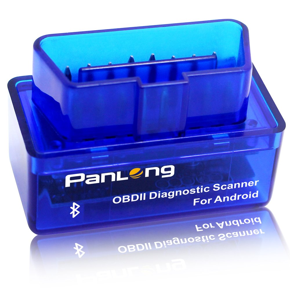

You may want one of these, they can be had for ~ $10 and will clear selective codes (via the Torque app). Plus they'll show you many measurement levels.
