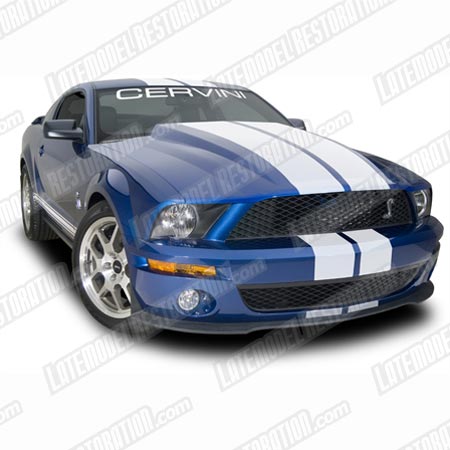

I had thought about doing a cowl similar to that of the new camaro. I think that would look really cool. Even something like the Shelby would rock to. A wide cowl that integrates into the hood.
