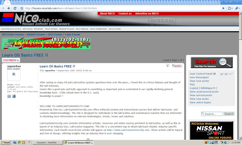

I wasn't kidding when I said like 50 tabs open tabs open:
http://picasaweb.google.com/lh/photo/vs ... directlink
