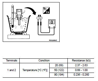

If you have a multimeter and want to test the temp sensor, here's the process:
TO CHECK ENGINE COOLANT TEMPERATURE SENSOR
1. Turn ignition switch OFF.
2. Disconnect engine coolant temperature sensor harness connector.
3. Remove engine coolant temperature sensor.
4. Check resistance between engine coolant temperature sensor terminals as follows.
Is the inspection result normal?
YES >> Reinstall sensor.
NO >> Replace engine coolant temperature sensor.
