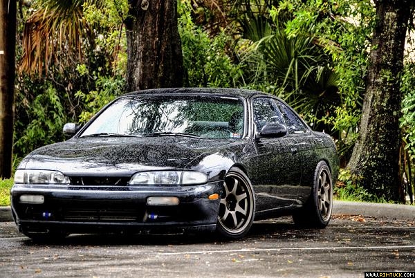

simmode1
Posts: 7918
Car: Red '95 S14
Location: Euless, TX
^^^Well, that really depends on the brand of tire your buy. Some tires run wider than others of the same listed size. Square fitment on a 17x9 should be 255/40. But when you have 235/40's that look this good on a 17x9, going bigger might result in that nasty over square look.
17x9+17 with 235/40 all around
17x9+20 with 245/40 up front
17x9+20 all around with 245/40 up front and 255/40 rears
They all look good. But like I said, some brands run wider than others, so fitment results may vary. 235/40's are the safest to avoid fender work while being a decent upgrade in treadsize over stock, IMO.
