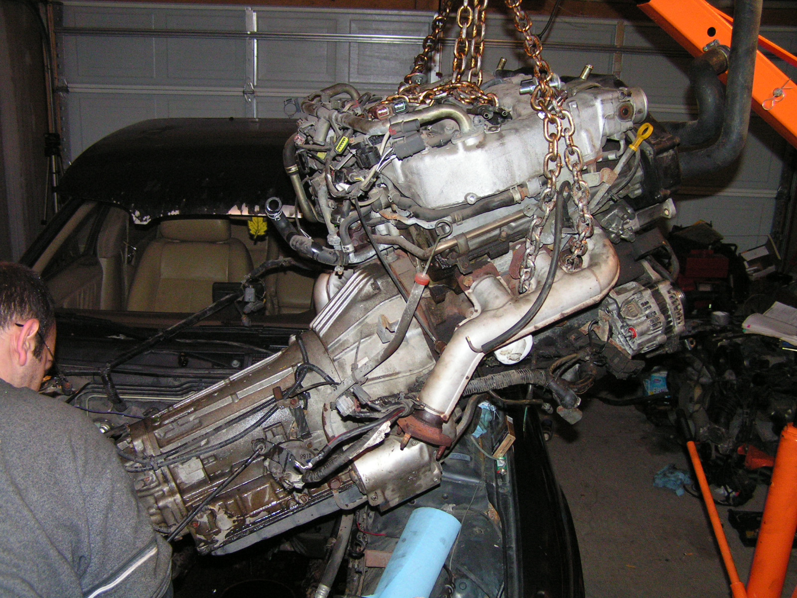

here is a pic showing the engine and transmission just hanging in the air on thier way out of the engine bay.....http://www.q45.org/Project%20J30tt/PICT0020.JPG.... it looks very intemidating, but it was a lot of fun actually, just take the safety precautions first, and enjoy.....

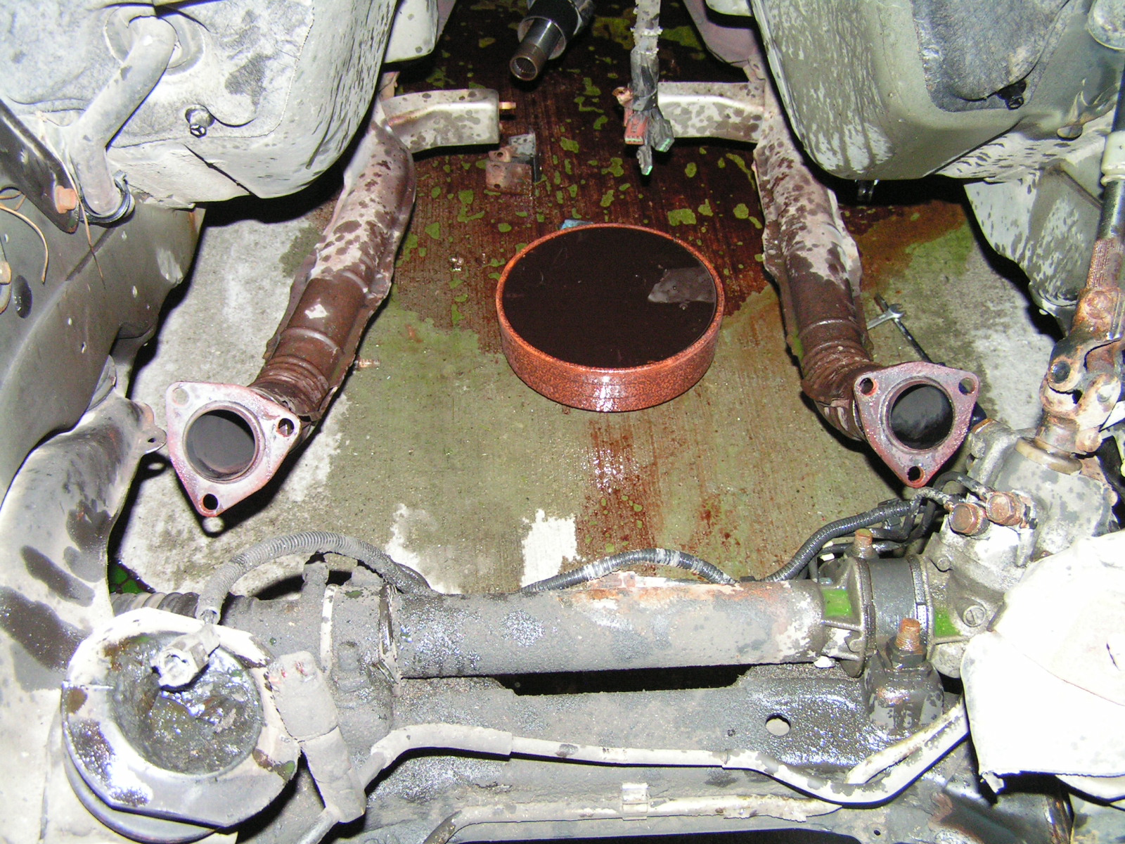

and here is a pic of the mess under the car after i removed the engine/transmission .... http://www.q45.org/Project%20J30tt/PICT0029.JPG..... note the drive shaft is just hanging there (it is attached to the car at the centre carrier)

remember what 95-j30tt said, drain the transmission fluid first and you floor will look like mine, no mess. And yes, it was a lot of fun. ( I removed the drive shaft also.)
