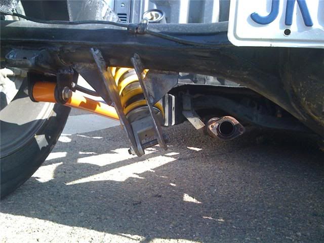

lol sorry for the crappy cell pic but yea i welded the diff truck is still not 100% done though
here are some updates
still need to shorten my driveshaft about an inch, box my lower shock mounts, and fab up an e-brake system.... but i drove it in the rain today and all i can say is SAVAGE
PEZi
Posts: 20441
Location: Pikes Peak, CO
looks good... but those welds on the frame for the coils look............... well let's say if you hit a pothole i wouldn't put money on them holding up for long
overall sick setup though man!
i'll be doing something similar.... SOMEDAY.... lol

well which set of welds the first pic of the uppers was done by someone else i had to cut them off and move them, i used a fat mig welder and braced them what about those welds?

Why the one forward and the one backward?
pejsa s-13
Posts: 529
Joined: Thu Sep 18, 2008 8:41 pm
Car: 91 HardBody, 85 720
wanted to keep the geometry of the stock shocks basically and figured out that it would give us the most progressive spring rate

seang wrote:Why the one forward and the one backward?
rumor is it helps with axle wrap as well

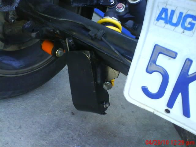

today i plated the lower shock mounts and bled the breaks and painted it all again

I like the cat design to the brackets.
pejsa s-13
Posts: 529
haha yea if you flip it over it looks like yoshi
