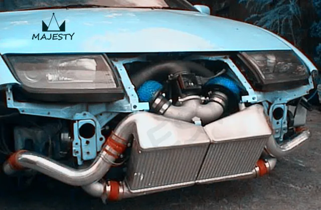

SOLVED! It was inter cooler piping. I have a FMIC although it is all open with no compartments, the fact that I had the same piping on both sides killed the airflow when it was accelerated. Thanks for you help!

I’m sorry to revive this but I have the same exact issue and also have a fmic. I don’t understand what the fix was please help

follow your piping routing and make sure that it starts at the filter and ends at the throttlebody. The issue here was that the piping was routed incorrectly at the FMIC essentially deadheading the turbos.

I think I have them correctly, I have just after compressor housings both going to the 2 bottom ports, then the two top ports go to throttle bodies correct?
NolimitZ32
Posts: 7042
Location: Houston, TX
If you have a cross-flow (air flows side to side)
then you did the exact same thing wrong that the OP did, you are deadheading (forcing air out of the two turbos to fight each other and go nowhere).
If you have a vertical flow (air flows up or down)
then your setup is correct.
From your description you have a crossflow so yeah. . . :facepalm:

I feel so dumb thank you so much I’m gonna try this as soon as I get home. I really thought everything would be symmetrical there
Dave5442
Posts: 4
Joined: Mon Jul 23, 2018 4:20 pm
Car: 1990z32 NA/TT
Yup that was it, thanks again for the quick responses
