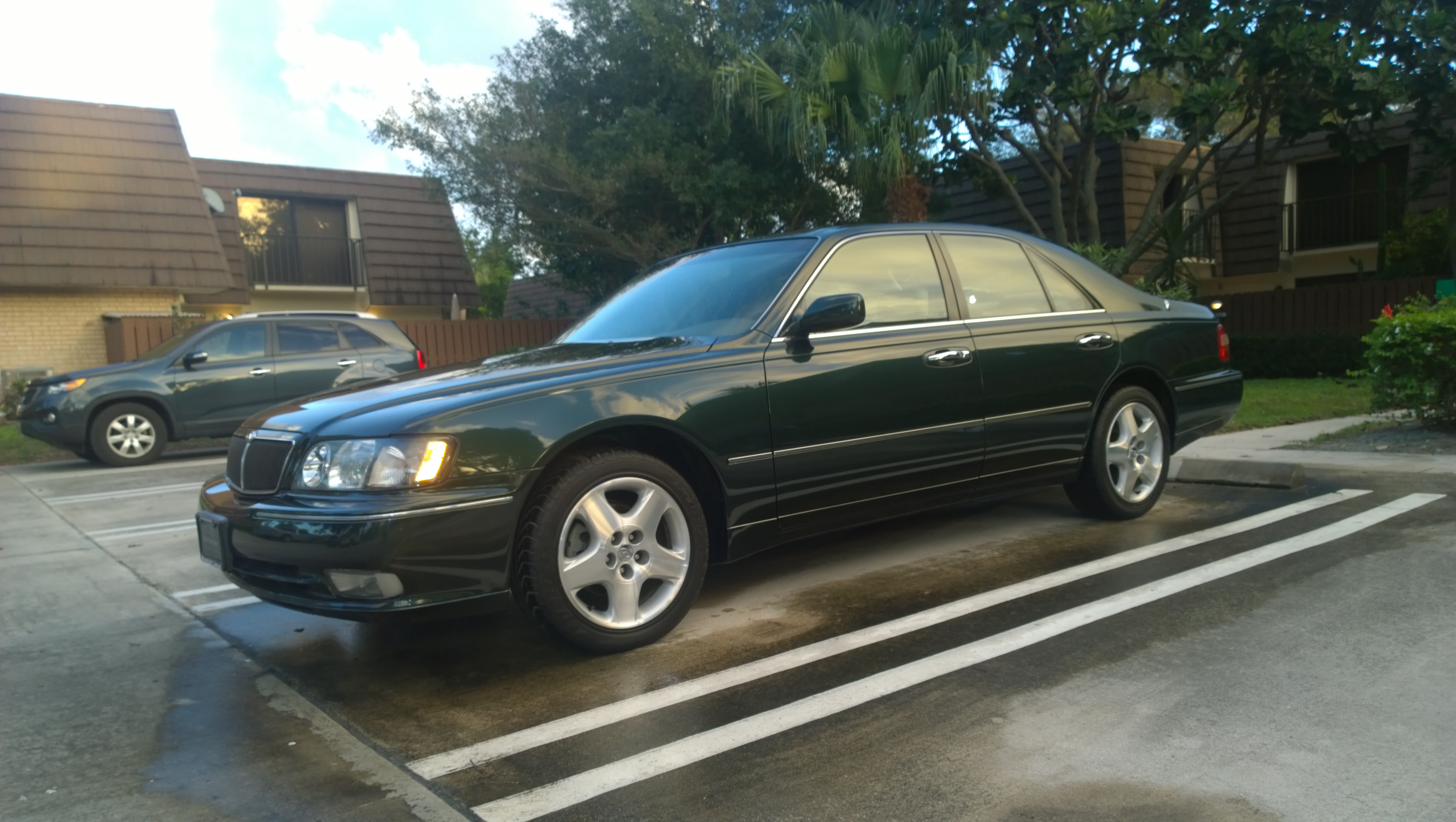

Your10 spoke wheels look really nice on this - but I don't want to roll the fenders and since I have a q45t it would mean BC-Coilovers and not sure if I want to VIP the car yet or lower it - I was looking at some 19 G37 sport rims - Yes - I know the 5x114.3 is common to a lot of cars - I am still learning about off-set - the 1999 q45 shows 41 offset? So yours looks lowered on 19's and with this offset you said you had to flair the fenders - is going 19 with stock suspension not going to work then or do I have to pay close attention to the width of the rim and offset? thx - still working out all the other details.... Another Nico peep says try looking at the FX wheels also...
1999 stock q45t
