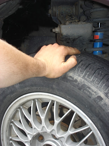

The way I could induce the play was to push firmly and sharply inward on the upper side of the wheel like this:
I tried pushing and pulling on the third link (like you said in your post) to induce play, but it was solid and would not budge.
I actually had to get my wife to help me by pushing on the wheel while I loooked around underneath. It's defintiely the kingpin because I could see movement in the place where the thrid link joins the wheel hub assembly. If I put my finger on it while the wheel was being pushed, I could feel the gap between the pieces and the angle of each piece relative to the other changing.

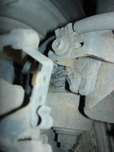

If you look in the following picture, you can see where the upper link joins the hub assembly. It's where the black painted piece meets the unpainted aluminum piece. Below this, you can see the lower kingpin nut. It is where the two pieces meet that I could see and feel play.

Make sure and get another Q savy person's opinion on that kingpin play. I also first thought it was play in my kingpin, changed the kingpin and the play was still there afterwards. I think that the knuckle arm might also wear and that's what may also need to be changed on mine, but I haven't done it yet. Double check. Those kingpins seem very sturdy and rarely need changing, judging by the lack of posts and threads on them.
