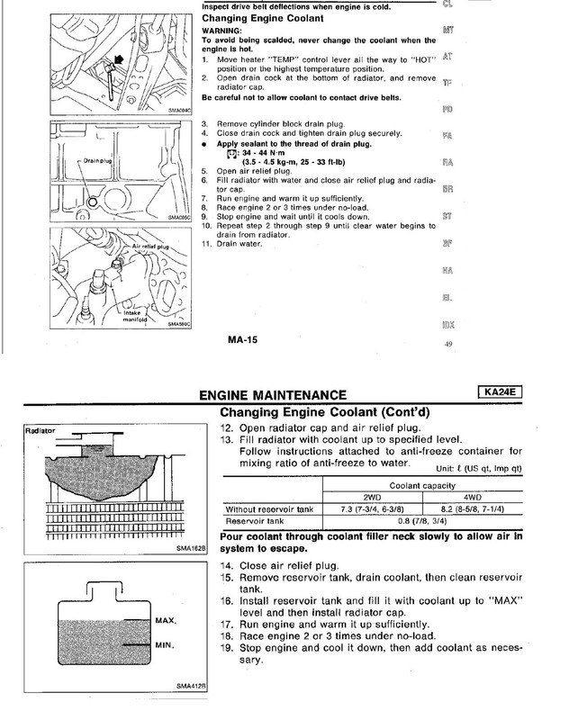

Flushing the entire cooling system on a the KA24E block according to the FSM is fairly straight forward.
Here is the FSM Directions on flushing the cooling system on a most Nissan D21s. FSM is for KA24E:
When running a cooling system cleaner, draining the block plug helps a LOT. The sediment and scale i've seen come out is crazy considering my regular cooling system maintenance.

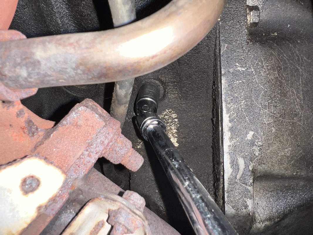

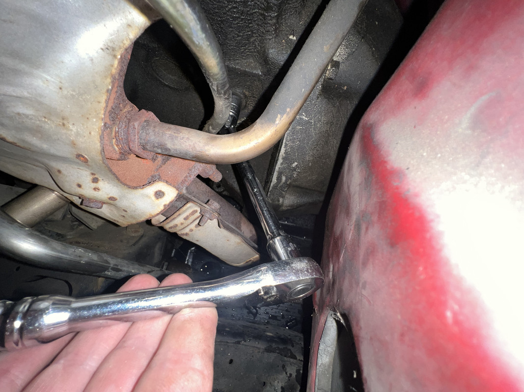

Steps:
  1. Hang a light off the brake line for max visibility. You’ll be able to see the bolt if you lean far enough back…..see video above for the “sweeping in” view.
  2. Put the ratchet setup UNDERNEATH the small EGR exhaust tube, and in between the dipstick and the firewall, and you’ll literally be able to snag the top of the bolt easily sliding the socket up and down against the block until it catches and attaches smoothly. Once you feel it catching you can probably lean back/adjust light if needed and see it directly to help attach if necessary. It should attach very cleanly and flush to the block with no risk of stripping and lots of room to maneuver.
  3. Once attached, if it’s the first time removing it (I had to remove it 6-7 times flushing the radiator before it was clean), you can swing the ratchet up from the position in the first picture below; and you’ll have tons of room to attach something as a breaker bar (I used an extension and deep-well socket).
  4. Once you remove it the first time, there’s no need to add thread sealant per the FSM or even tighten it back down past snug to keep flushing the system, as I never leaked a drop doing it that way while the engine ran for 20 minutes each time. I would add the thread sealant when putting it back in for the final coolant fill though.
