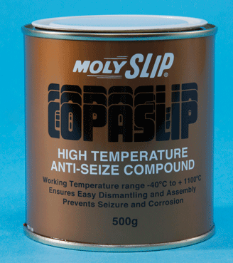

And everytime I remove the manifold, I sure will use this kind of Anti-Seize Compound on the thread,
This will prevent rust on the thread, and last for years.
The one in the photo is not the best, it will dried after hard run.
I have another brand of same grease which will last longer, but I can't find the picture on google.
