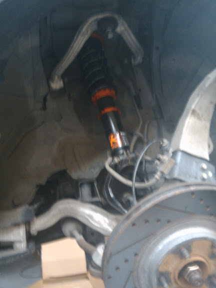

spoke to eibach and they r also ablt to fit AWD FX35/45 and AWD m35/45 with a Front Fitment
Camber +/-2.50. Can u please post picks of the camber kit u had installed....plus a member gave me a number to a guy on this forum that makes
them....i called, left a message and never got a call back...
Trust me when say the are wrong. There are no cam bolts for the AWD. The AWD has an axle to clear and thus there is a fork (honda like) that mounts to the spindle and the spindle is VERY different from the non-AWD.
Notice the fork there for the front axle...there is no place for camber adjustment there...you have to use the upper control arm to adjust the camber on the AWD. No way around it. All I did is buy grade 10.9 bolts (overkill, I know) and had a machine shop mill 1mm off for the length of the mount. The "kit" is not visible to take a pic of. If you look at the pic above, you'll see the upper control arm...the bolts allow play in the control arm to adjust the camber.
As far as Chris not calling you back, that is unusual, but not out of the question...I will talk to him about that.
im a RWD so i shouldn't c y these cam bolts wont work fine on my car.....how much could my camber be off from stock spec? on coilovers
Right, cam bolts will work for RWD, just less adjust-ability than the control arm bolts with the same diameter decrease. You stated that Eibach told you it would work for the AWD and I was explaining that this is not the case.
Coilovers will depend on how much you drop the car. I dropped mine almost 2.5 inches and I might go a tad more to close the gap to 1/2 above the tire. My camber was -2.3 with the almost 2.5 inch drop. I have it in at -0.8 front and rear.

got my eibach cam bolt....now where r these bolts go to adjust the camber....note: these the the lower bolts not the upper control arm bolts....
terrycs
Posts: 286
Joined: Tue Feb 20, 2007 8:58 pm
homeblue90 wrote:got my eibach cam bolt....now where r these bolts go to adjust the camber....note: these the the lower bolts not the upper control arm bolts....
There is no such thing as camber bolts.
If the M is set up like the G, the rear has camber arms AND toe bolts. The front camber can only be adjusted using new upper control arms.
Some people can get away with not using the toe bolt in the rear and just installing the the rear camber arm.
Eibach normally uses a company called SPC as their supplier. That means if you buy the Eibach alignment kit ... you are really getting a kit made by SPC. Here is their website: http://www.spcperformance.com/
Now the bad news ... according to the site above, SPC doesn't have a kit for the M.
Maybe Eibach is dirtibuting a kit for the M made by another supplier?

rgb129 wrote:You shouldn't need the rear. I was able to get mine adjusted to -0.8 and I am dropped lower than you are.
The bolts can be ordered from Chris at Precision Motoring. They are a NICO sponsor and active in the Nissan world. His number is 615-750-3892. I believe he is selling them for $150 for a set shipped.
Just realized after I looked at the number that these guys are right down the road from me. I have actually called Chris before and asked if they do UPREV dyno tunes! ha

homeblue90 wrote:
DoN_BLaZe34 wrote:so what became of the eibach camber bolts you bought??
Nothing at all....returning them back to eibach
Did you even try them? Like I said, using the cam bolts as a way to adjust is not the best place to do it. Either upper control arm bolts like what I did or an adjustable upper control arm like you ended up buying is the only way to effectively get the adjustment you need.

homeblue90
Posts: 93
Joined: Mon Nov 03, 2008 11:41 am
Car: 2006 M45
Did you even try them? Like I said, using the cam bolts as a way to adjust is not the best place to do it. Either upper control arm bolts like what I did or an adjustable upper control arm like you ended up buying is the only way to effectively get the adjustment you need.[/quote]
yes i agreed with u, thats y i bought the upper control arms instead....what u said made much sense...thanks for ur input

camber bolts from Chris:

drilling the sleeve in the bushing with a 15/32" drill bit in order for the camber bolts from Chris to work.
