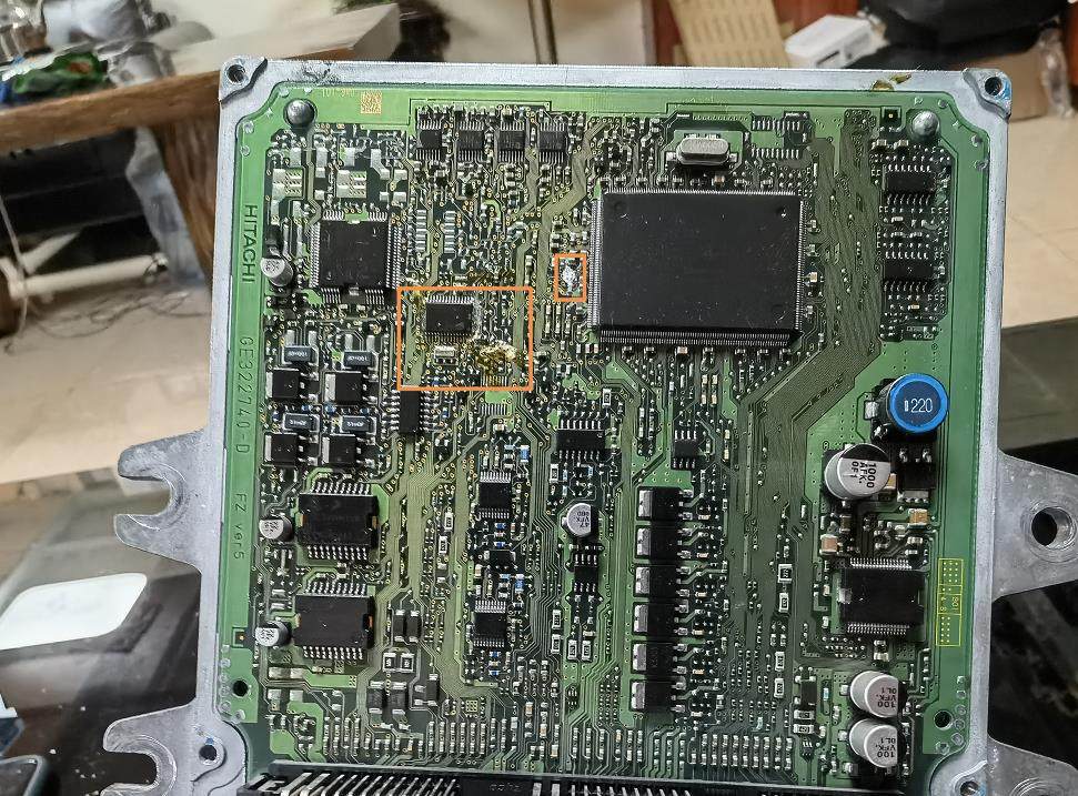

I have a Infiniti Q70L with VQ25 engine, and I swap into VQ37VHR.
After that, I turn the engine by ECUTEK by a tunner, the program work in first 2 tunning files, then the ECM was burnned in third file rewrite.
Have anyone ever burnned the ECM by ECUTEK?

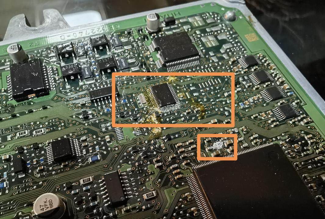

That isn't burnt, it's corroded. The circuits were heating up (that's evident from the melted conformal coat), but it's likely the problem was developing long before you attempted to tune it. My guess is the tuning process was utilizing circuits that are dormant in normal operation, and one of those is what failed. However, with that much crud on the PCB, it would have failed you anyway at some point in the future. It's probably fortunate that it crapped out in the garage and didn't fail in operation and leave you stranded or cause an accident.
Thanks alot, I also sent email to ECUTEK, they said burning ECM have never happen, but I still confuse.
