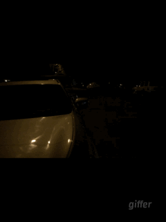

DoN_BLaZe34 wrote:Bringing this back from the dead
Haha. It has been dragging on.
The LED strips that I initially installed started having LEDs fail. Replacements were sent by the seller but those were not much better. I ordered a different set of amber only strips from a different seller. They are installed and working as of a couple weekends ago. I have not had time to take decent pics and finish the write-up for AZHitman.
Quick dirty preview...
