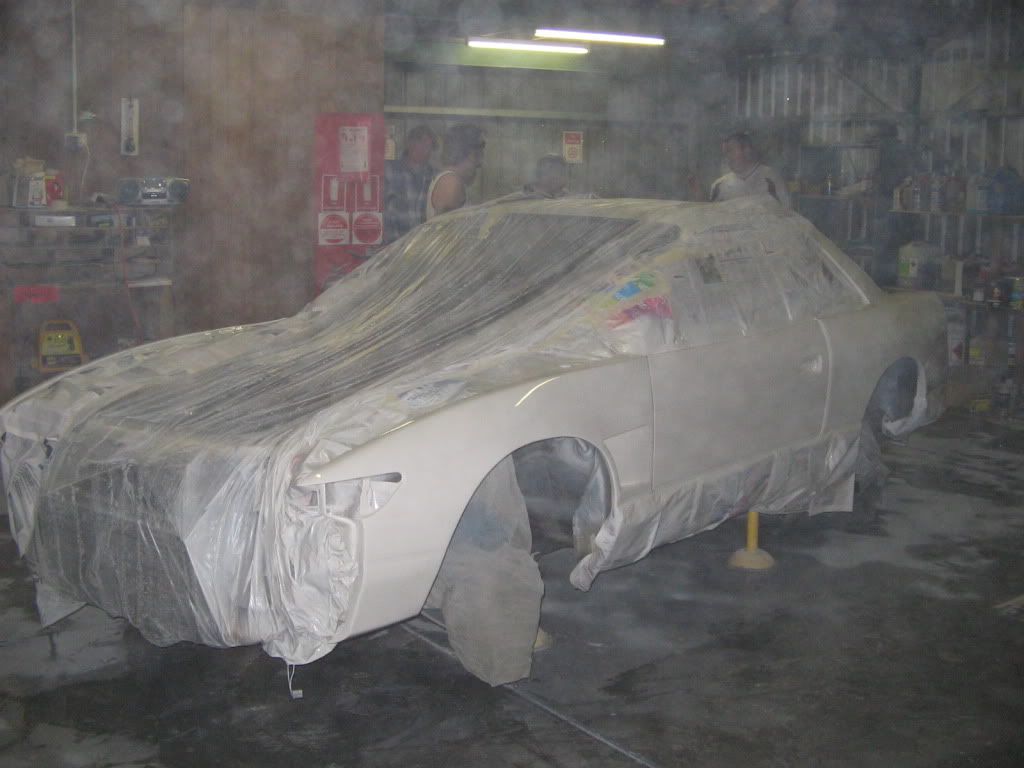

Exterior:
---2008---
---Currently---

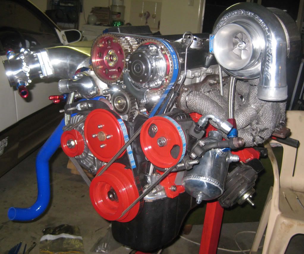

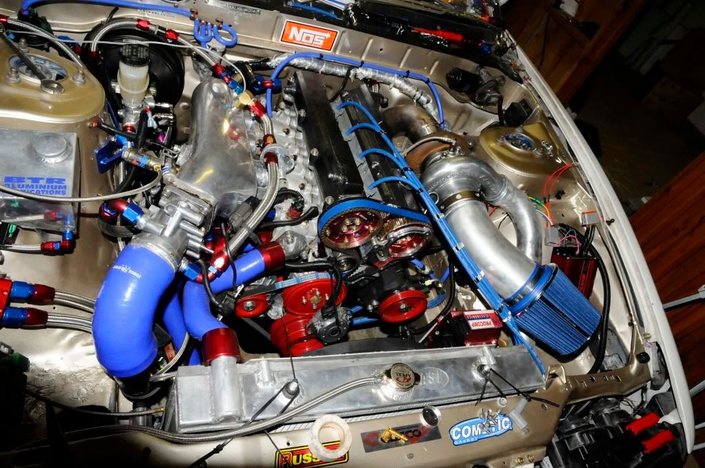

Engine:
---2008---
---2009---
---Currently---

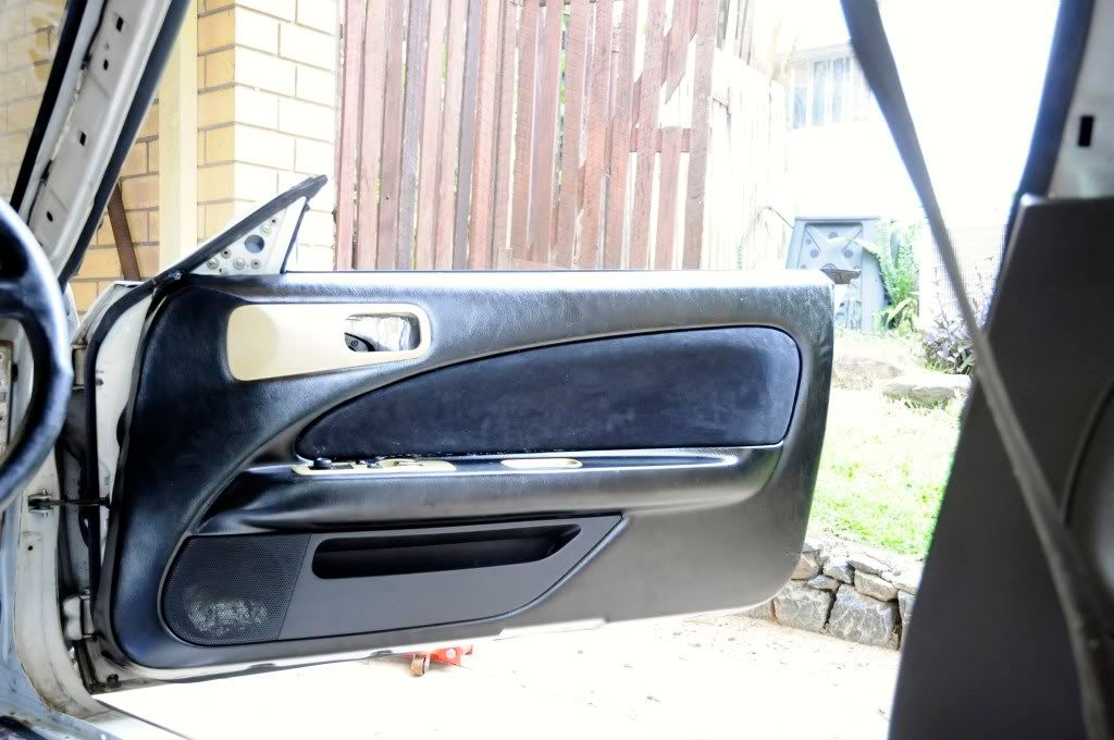

Interior::
---2008---
---2009---
---2009/2010---
---Currently--- (S13/15 Hybrid Interior)

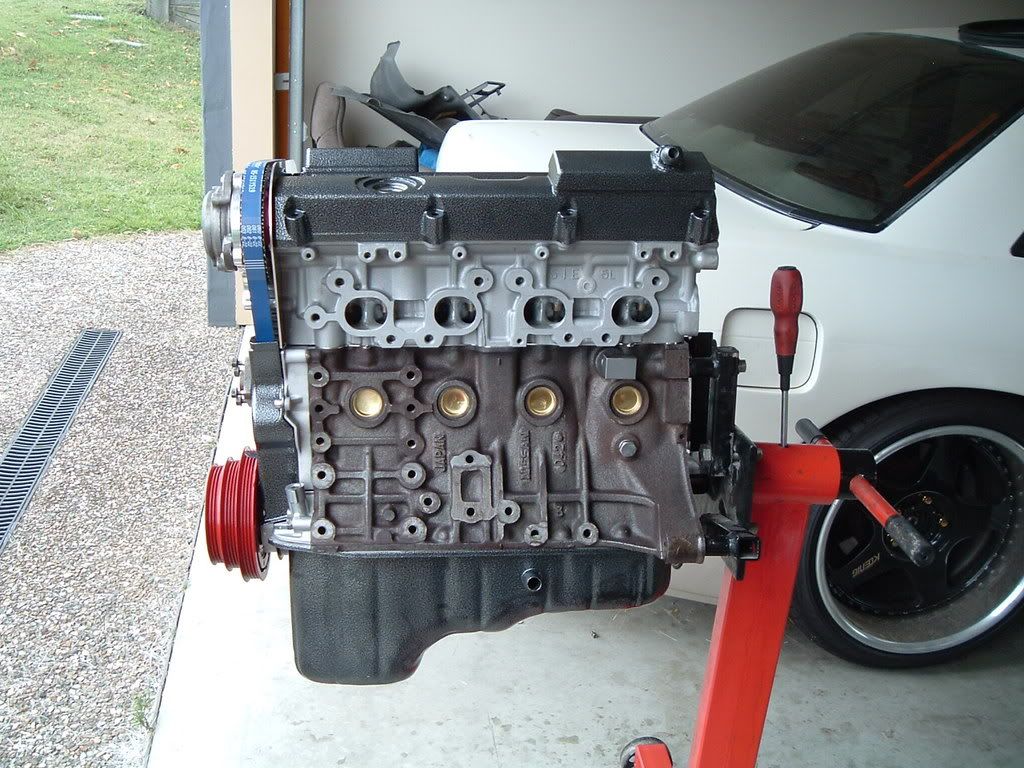

Sick start man i can't wait to see it all wrapped up. I need more info on the following:
Block Precision Prepped and Grout Filled
Conversion to 90% clampless water lines (all dash fittings, bungs welded where required)

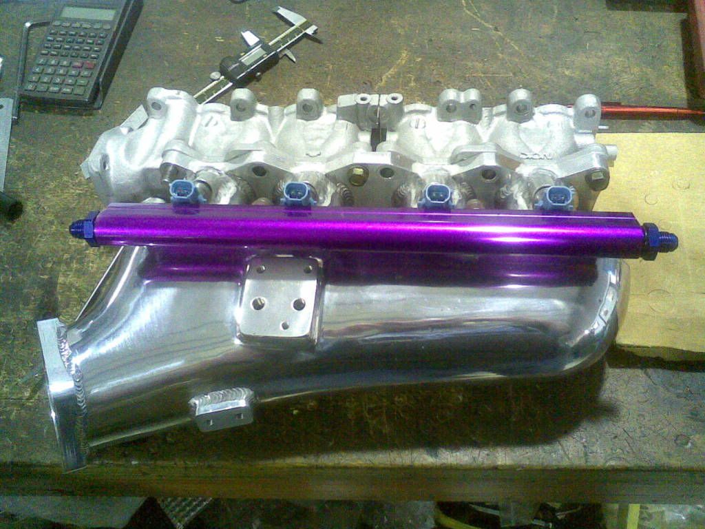

I'm not to familar with what these processes are can you shed some light on them. Also you said you moved your injectors to the underside of the plenum. Do you have pics of there placement and what you did to the stock injector locations?
Cheers
EDIT: What are the specs on the cams you are running?
meminto
Posts: 607
Joined: Mon Apr 28, 2008 12:46 pm
Car: S13 Silvia CA18DECT
Sorry mate all specs on cam profiling, flow rates are pretty well under wraps until its all completed...
Block has been thouroughly prepared, grout filling is to stop bore flex (strengthening the block)..
No pics of anything else so far, I cannot take full credit for the clampless fittings process as I had help, however I am also keeping that process under wraps.. until its all completed..
I am happy to provide more info once everything is complete to help the broader CA community, but I also need to be a little selfish first
Cheers

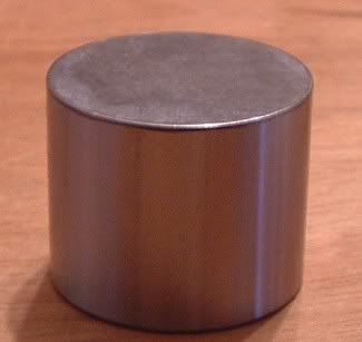

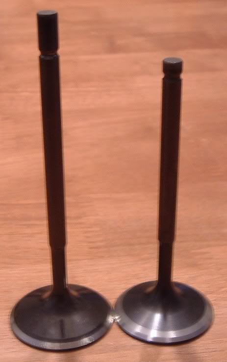

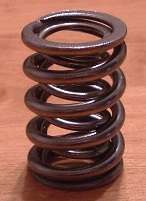

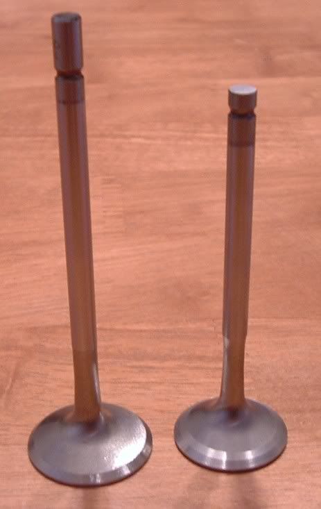

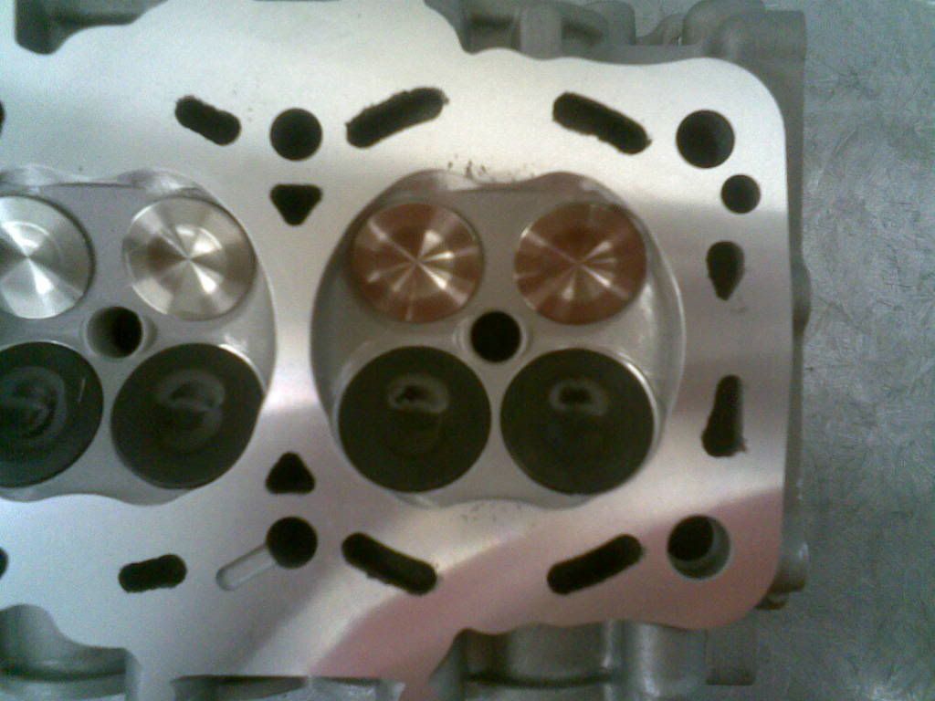

Some more gear arrived today, all the valvetrain arrived...
Dual valve spring..
RB25 exhaust valve is on the left.. (CA on right)
On the inlet its not very clear, RB on left is +1mm..
Solid Lifter..
Titanium Retainer (Although I think its a little bling more than anything)..
All up the entire valve train will only weigh 2168 grams (not inlcuding valve guides, cams or shims) I will need to weigh the stock setup..

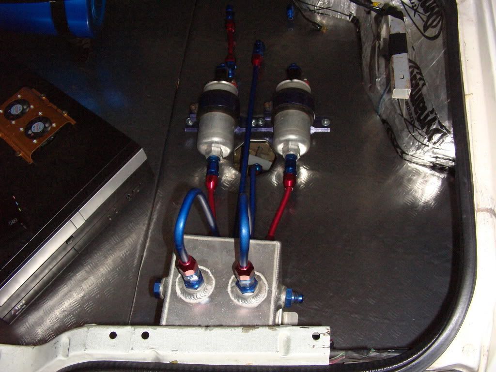

What size AN are these?

if i had to guess personally, id say -8. ive got -8 on mine right now

Correct they are dash 8 fittings...
The build consists of multiple dash fittings from dash 3 right up to dash 12 for a variety of cooling, brake, powersteering, fuel and oil lines..

meminto wrote:Some more gear arrived today, all the valvetrain arrived...
Dual valve spring..
Solid Lifter..
Cheers
dare i ask....how are u gonna use the RB valve....boring?
what was cost... cuz im getting close to my 5k goal for my rebuild
but i dont know if i should wait till the motor blows
meminto
Posts: 607
The RB valve was chosen for its stem length (still needs to be machined to suit the lift), plusses are the extra sufrace areas of the valve heads..
The extra surface area of the exhaust valve head interested me the most as it will increase the efficiency of the exhaust flow (with ca valves it was 83% efficiency at peak flow)... but yeah boring will be required...

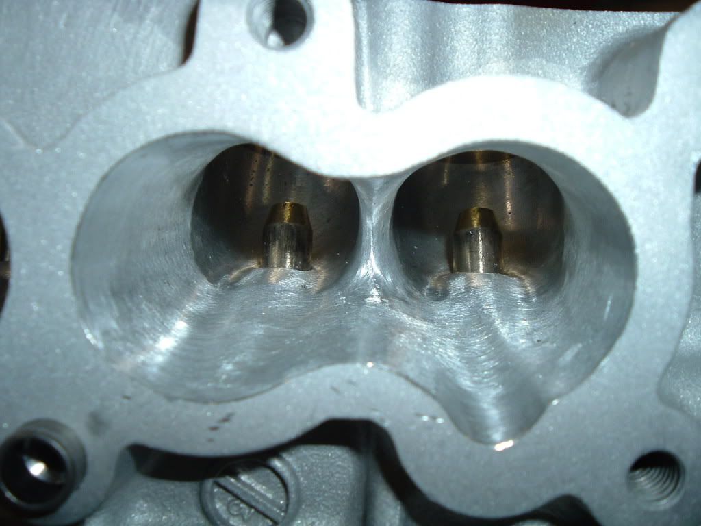

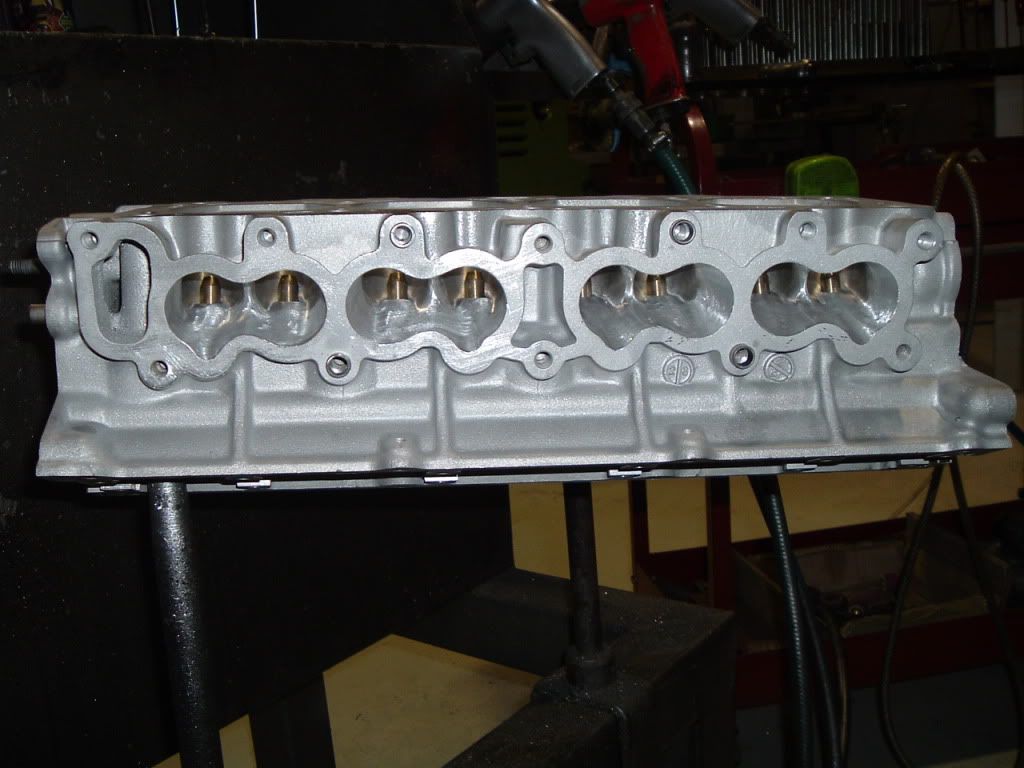

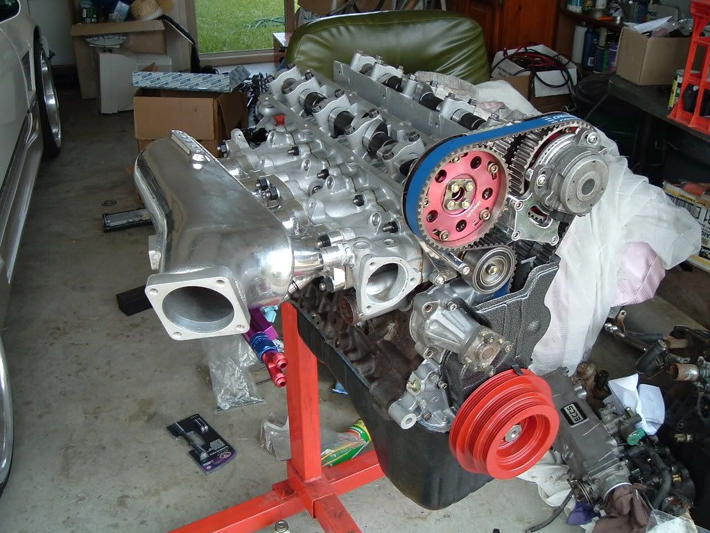

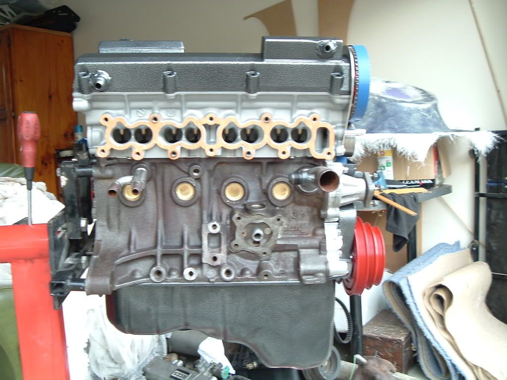

are those aligning pins on the head something you added for the intake mani, or is that nissan standard for the 4 port head?
Greg
meminto
Posts: 607
Hi Greg, The dowels have been added by my engineer to ensure the correct alignment, they are not from factory..
It is also an eight port head, not a four port... its just had a lot of material removed..
Cheers
