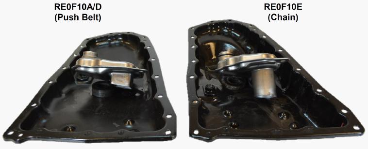

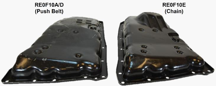

Also, I found something else out that is pretty cool, if you wanted to
expand the trans fluid capacity of the Rogue.
The Murano trans pan is deeper, and has a valley in it for the Murano
filter inlet. You could buy a Murano filter kit, and trans pan, and get another
2 quarts volume in the transmission. The bolt pattern is the same for both
the D and E trans. However, yeah, the E pan is deeper and holds more
fluid.
I guy I know has a '17 Murano, and he told me he took six quarts out of his,
and I did not think that was right, as I only got four from mine. After
I saw the difference in the pans, I now know he DID get six from his.
So, if I ever come across a Murano pan, I will get the Murano filter kit and
increase the volume of fluid. Will also reduce temps just a little..

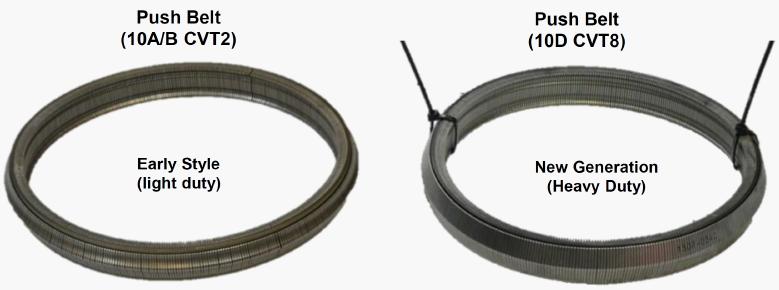

The CVT8 (10D) has a heavy duty belt:
The 10D is a stronger more heavy duty style push belt and has 423 steel plates.
This one doesn't wear as fast as the thinner one did. I read somewhere that
initially, during a break-in time, you wold see some filings on the
magnets. SO, either mine was changed at one point, or are prettly
lucky thus far. It's starting to whine or whir at low RPMs, and I hope it is not
the reduction gear bearings.

After break-in, neither one of them will actually "wear" if the fluid is well-maintained and there's no overheating. Fresh CVT fluid from any manufacturer has more than enough film and shear strength to completely prevent metal contact under practically any circumstance. Problems happen when old fluid meets heat and shear force, and the big improvement in the '10D belt isn't just strength, it also has a larger heat shed area (the non-contacting portions of the belt). In any case, there are always initial shavings after break-in, but usually little or none after that if the magnets are cleaned and the fluid kept fresh. So yours was evidently cleaned out at some point.
Vis the noise, are you using NS3? It's a good fluid, but from a noise standpoint, definitely not the best. My customers using AMSoil and Eneos all agree that their trannies run noticeably quieter after changing over, and while I can't personally vouch for other brands, I've heard good things about Castrol and some others. So you might simply want to try a different fluid.

That is pretty freakin' cool. I have a few customers who tow with Rogues and some extra fluid capacity would be a definite improvement. I don't think all the '10E pans have identical contours, is that the '17 Murano pan, or do you have a p/n for it?
Yeah, it looks like the slanted sides are opposite each other.
The slanted side on the rogue is on the left, facing the wheel side.
Looks like the Murano pan slant is on the right, facing the oil pan.
Like they're mirror opposites, but man, I would like to see if
there is one that does fit that is deeper.

PowerslavePA wrote:
Sat May 20, 2023 9:57 pm
The whir is there at IDLE while in Park Neutral, or Drive, and goes up with engine RPMs, till it goes away at about 1500 RPM. Sounds like a Whiny power steering pump, but not as loud.
Put a steth on it, that might not be the transmission. The overrunning clutches on all late model Nissan alternators are infamous for a variety of buzzing noises. I've also heard auto-tensioners make some pretty bizarre noises on occasion. If you do hear it at the bellhousing, it has to be in the Torque Converter sprag clutch or the front pump. Nothing else in the transmission is spinning in P or N, so that pretty much leaves out everything downstream of the pump.
VStar650CL
Technical Expert
Posts: 11931
2004 Nissan Altima 2.5 S
PowerslavePA wrote:
Sat May 20, 2023 10:17 pm
We have them open and apart in various states on the shop floor all the time, I'm going to start looking and comparing. In the mean time, the biggest problem with fluid breakdown is heat, and the biggest problem with heat is that the damn beehive never stops pumping it into the system even when the transmission is hot enough to fry eggs. Our buddy Macgiver put a manual coolant cutoff valve on his Juke to kill the stupid thing when he drives into the mountains, but I actually designed an automatic one that I'm selling. I shared the development cycle with the crowd in this thread...
mountains-cvt-did-the-oil-cooler-instal ... 74-30.html
I don't want to be accused of free plugs so I won't post a sales link, but if you routinely do mountains or tow anything, it will definitely help with the fluid deterioration problem.
