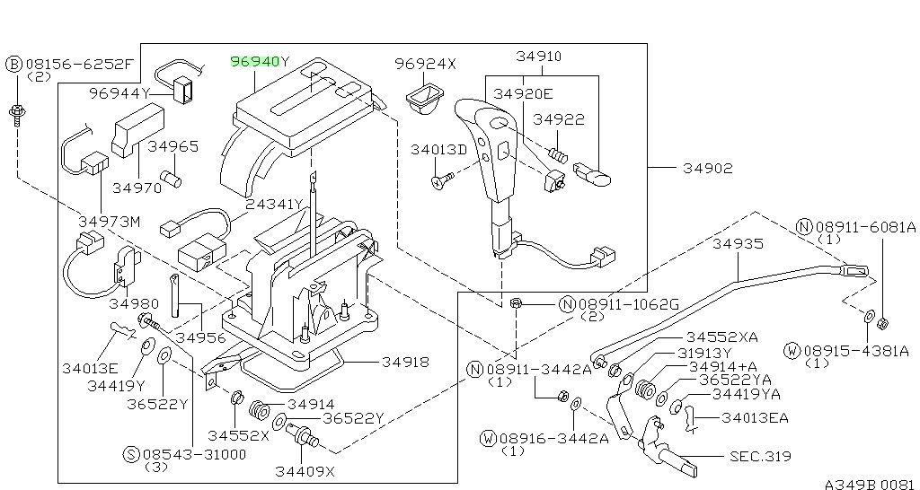

But now I’m pissed because it’s so hard finding replacement anything in the Midwest for this one. However, I tried some time ago to take the shift lever off a salvage car with the heated seat option, since my replacement seats are from one with the heated option. However I remember being unable to figure out how to get it off. The shift knob leather part will come loose, but it won’t come off enough to slide the shift console out. From what I guess, the whole console with the shift lever needs to come out together?

Looking at the FSM, it appears the shifter bezel is linked at the back with the card pocket (2 screws), which has to be removed before the bezel will come out. You also usually need to have the shifter in N or D to get a shifter bezel loose from the console, that's true on almost all cars.

Just getting back to this, but yeah I see a diagram that looks like it should just unscrew loose. But I remember it was something that I could not separate the shift lever at all. It was loose and moving, but it wouldn’t come off. At that point, I’d already had the display off and could see thru to the ground. Here’s the diagram below:
