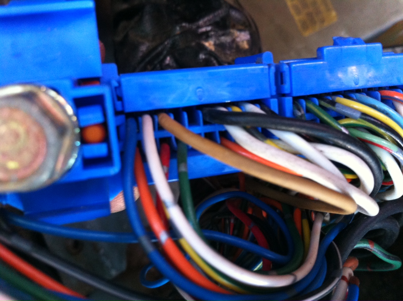

here is a pic of the wire in the ecu do i just cut it 6 inches from the pin start a new wire? do i pull it from the terminal, put another wire in there to ensure a good connection at the ecu and soder the oem wire to that?
does anyone have a good picture of what jumping it with a 1mohm resistor should look like?
I'm almost willing to take any route by now just to get it smogged and registered! like i said i just bought it

I just want to jump it at the ecu because I suspect that cable is busted somewhere. Would I just pull the wire from the terminal solder a small wire to one end of the resistor then cram that end into where the old wire was , then ground the other side of the resistor
